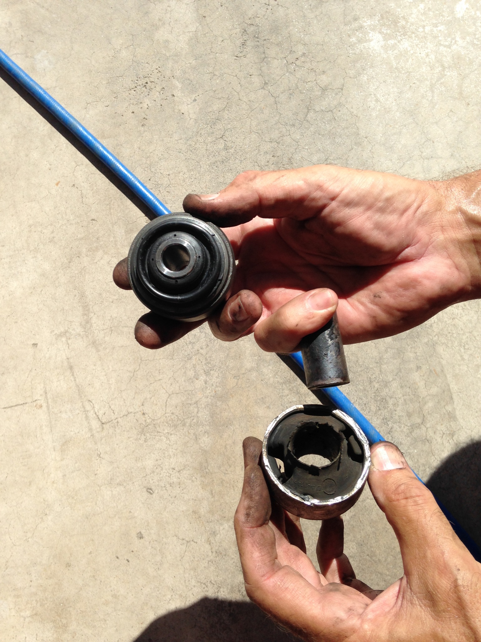

Order Moog K200792 bushing bearings, if you can't press them then have a machine shop do
It! Well worth the effort, I changed mine with an air chisel the first time , and a ball joint press the second time!
The first replacement rubber bushing is on the right with approximately 60,000 miles, that was an OEM GM bushing! Yeah!
The Moog bushing is on the left!
