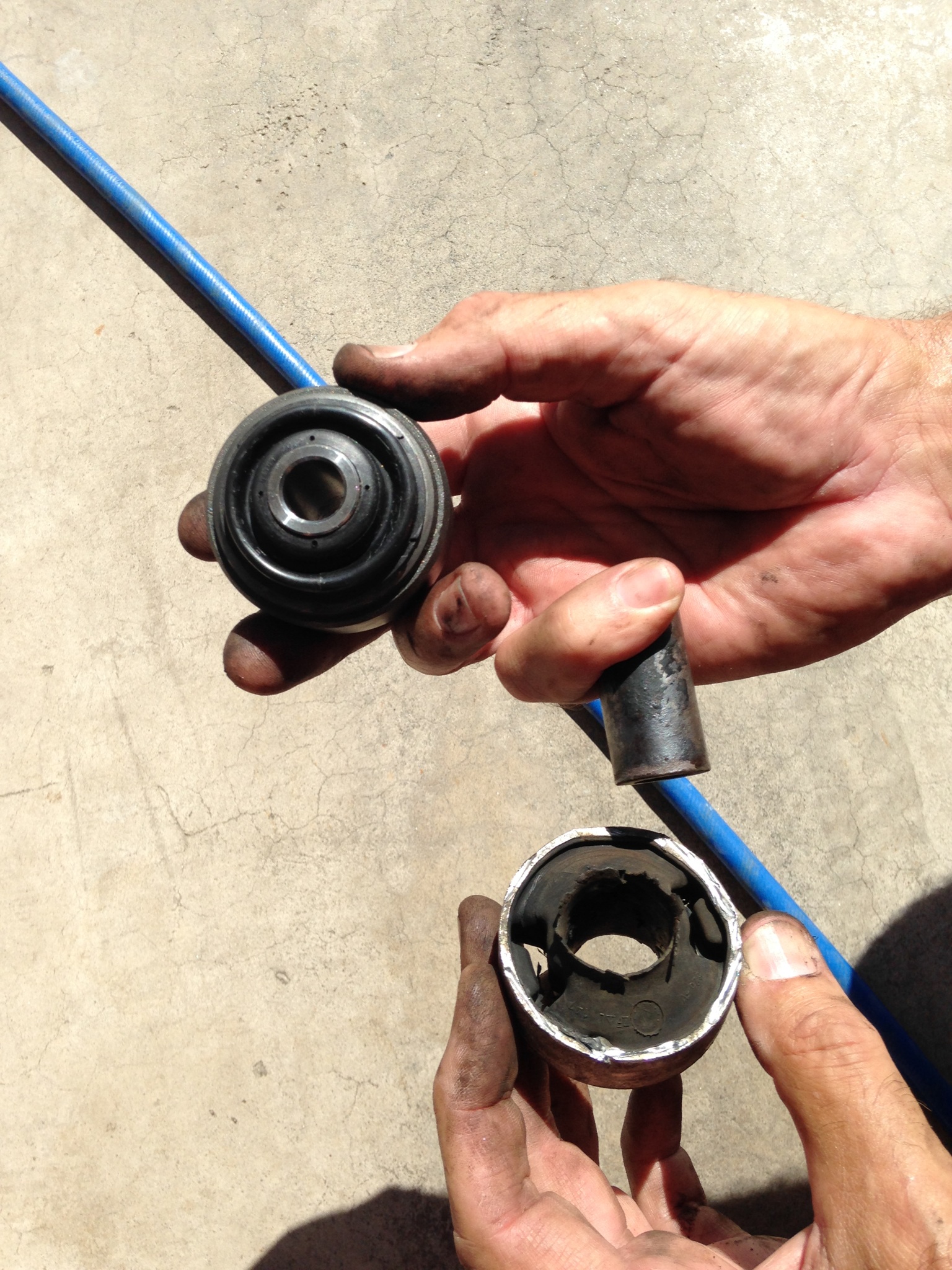

LCA bushings press out the old press in the new! You can see the deterioration on the two piece OEM part on the right
I highly recommend Moog K200792
https://m.summitracing.com/parts/mog-k200792

Had it on a lift today, and u were right it was the control arm bushings. I did notice that it has a oil leak from a sender that is above the starter. Any idea what this sender is for?
