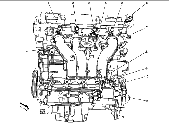

You mean like this?

Originally Posted by donbrew
You mean like this?
must be it. it's right above the starter. Just looking to get all the parts together when I do the job..
Thank you

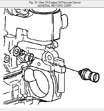

You mean like this?
Do you know the part # for 2.2?
Old Jan 21, 2017 | 06:04 PM
Posts: 39,989
A great how to
https://www.chevyhhr.net/forums/how-...t-57962/page2/
And for the switch
More Information for ACDELCO D1849A
