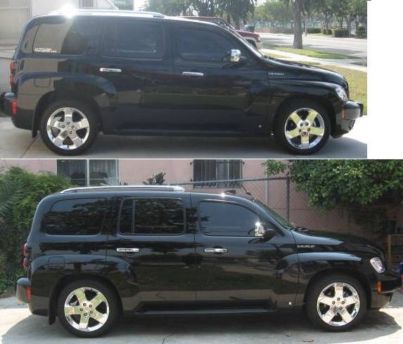

From: SoCAL & Louisville, KY
Blackie before and after leveling
(With help, ok A LOT of help from the gentlemen who posted above)
Also have a Progressive sway bar--I love how he rides now--smoother and don't feel like I'm tipping when making turns.
Goldlines are from HHRBoutique. Oh yes--Blackie has leveled out just a bit more from this pic. I'm 5'1" and can reach more across the top to clean (but still need a step stool).
Is the ride stiffer?

Norsican, so you're the one who stole the IBM I wanted!
Always my first choice color...
OK, I don't think so. Don put them on 4th of July and in the month I've had them, it just feels smoother and more even. The drive isn't stiff at all. I don't go speed racing in this thing--it is my daily driver. I have a 2LT if that helps.
The sway bar made the biggest difference (had that put on in May) in making it feel more grounded. I agree with what Don says, I think it makes it look better and have no problems going over dips and such.
Much more subtle of a look and feel. Don't know how others may feel it.
