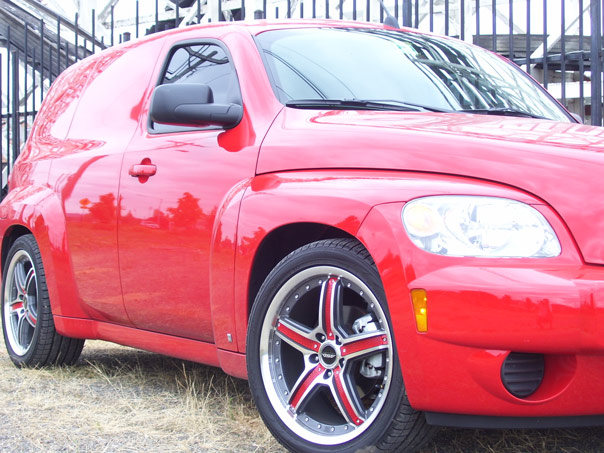

This is what the Eibach Pro kit did for mine on 245/40/18s:
The ride is more sporty than stiff, and corners well w/o anti-roll bar. I've also gained 4-7mpg.
