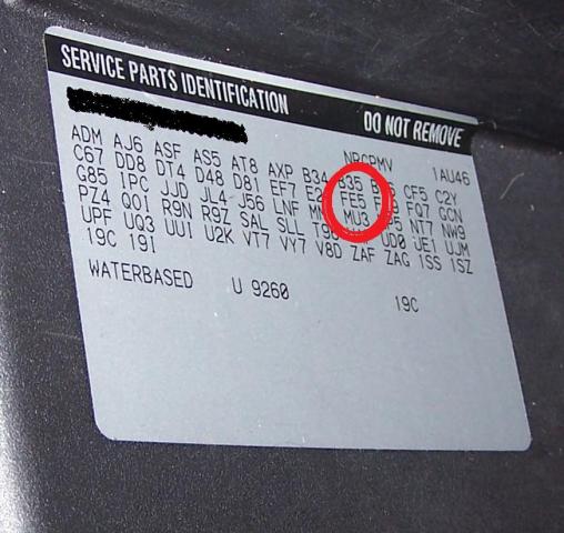

Your SS, if still stock, will have the FE5 suspension. It is listed right on the RPO sticker in your glove compartment.
Something like this.
Name:  RPO codes.jpg
