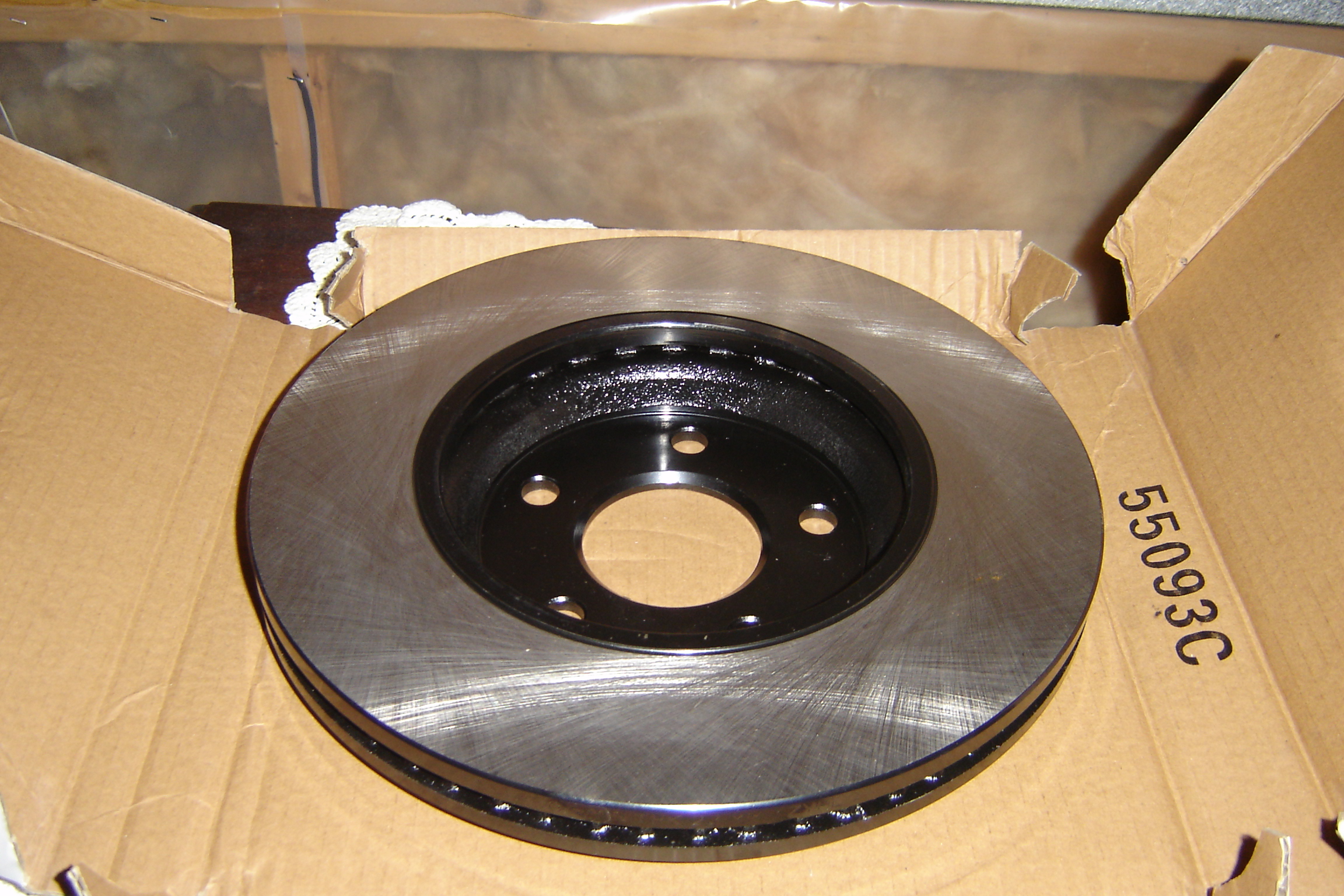

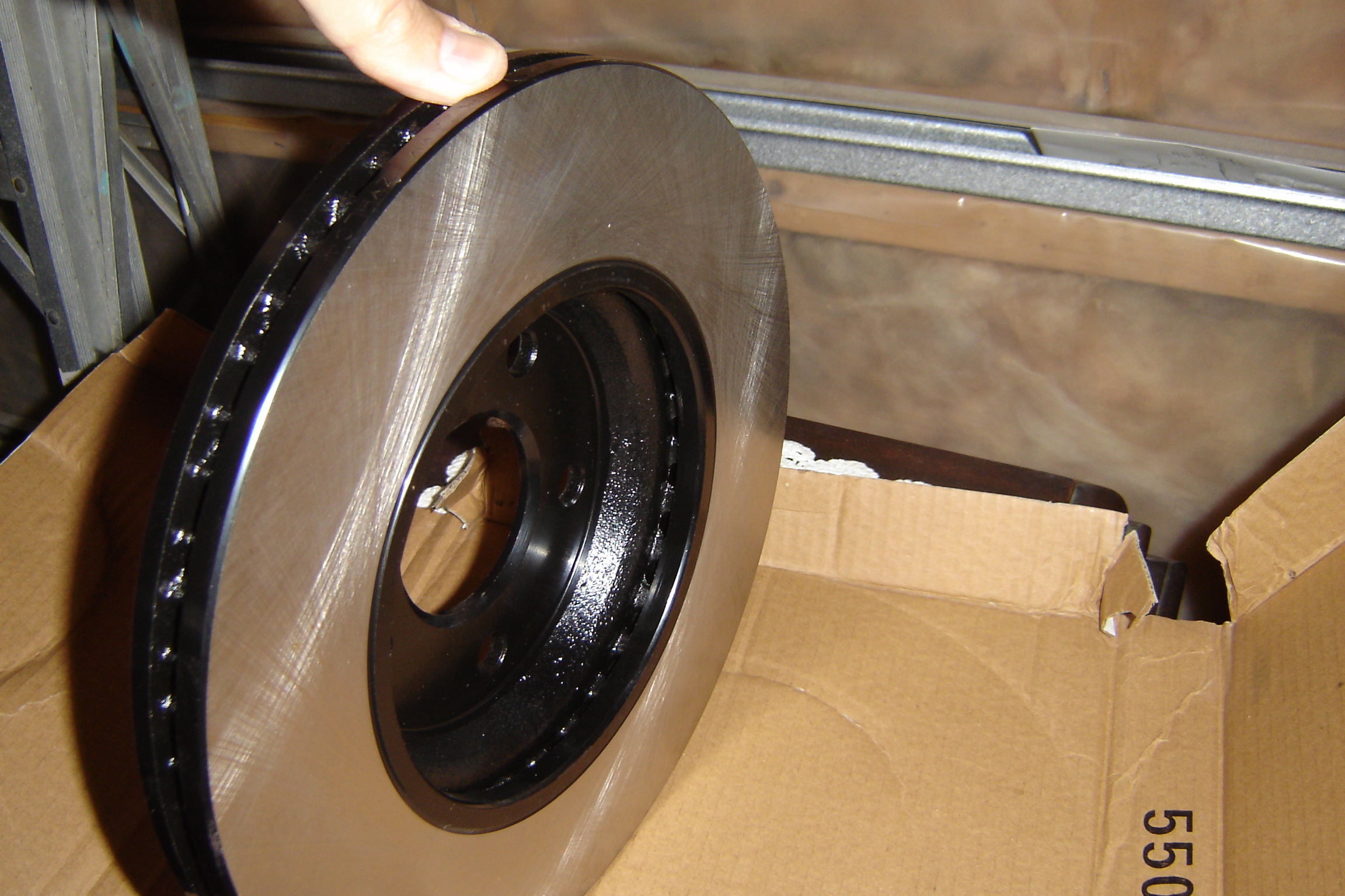

crossdrilledrotors.com give their site a look! I have their Premium rotors, never saw the advantage of drilled or slotted rotor.
I've had them approximately 35,000 miles and no judder or pedal shake!
