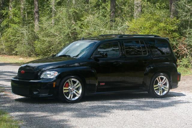

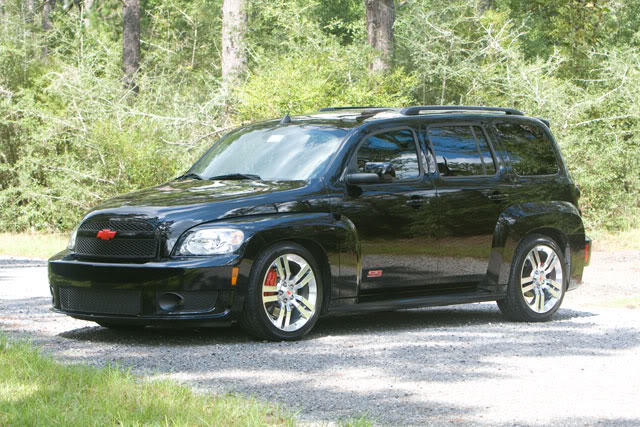

I installed Pedders on my SS back in Sept and really like the look and ride no issues at all.
Pic
