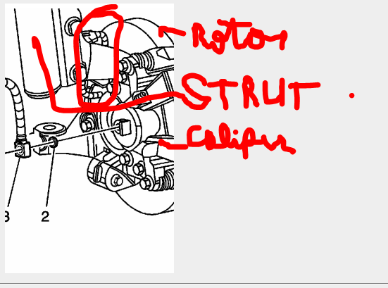

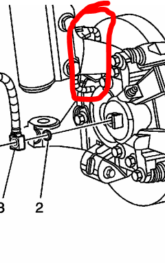

You damaged the wire or connector for the ABS.
Old Apr 19, 2016 | 04:00 PM
Posts: 26,533
This wire in red circle.
Old Apr 19, 2016 | 05:54 PM
Posts: 40,083
Double check that wire connection
Where is that located exactly?
Old Apr 19, 2016 | 06:48 PM
Posts: 26,533
The picture shows it on the back side of the hub, the connector is on the strut.
See Post #3
See Post #3
OK, I will check it out tonight. Thanks. I'll update what I find.
