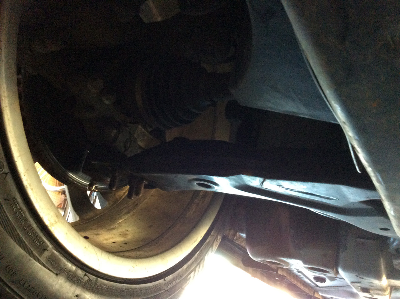

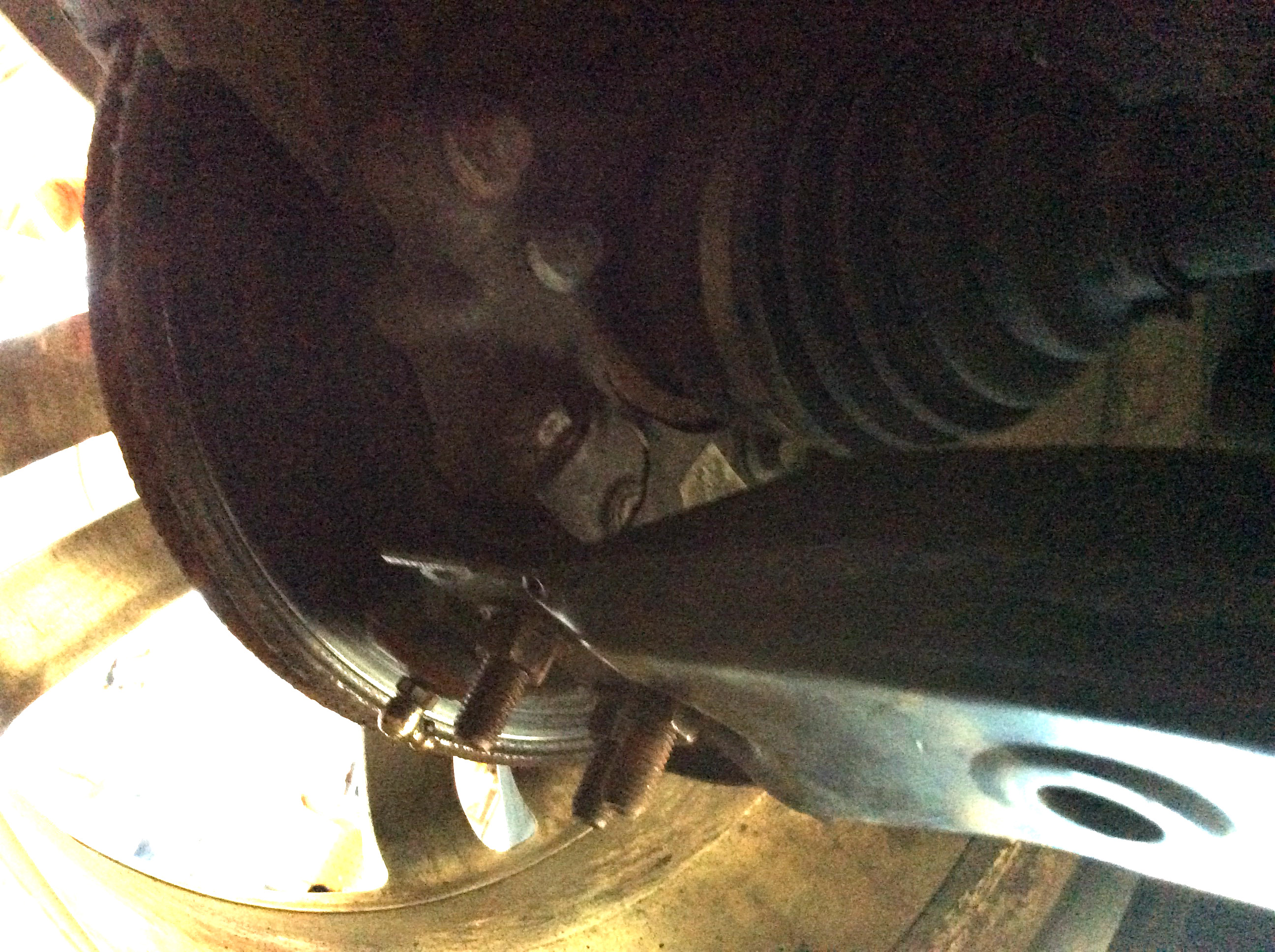

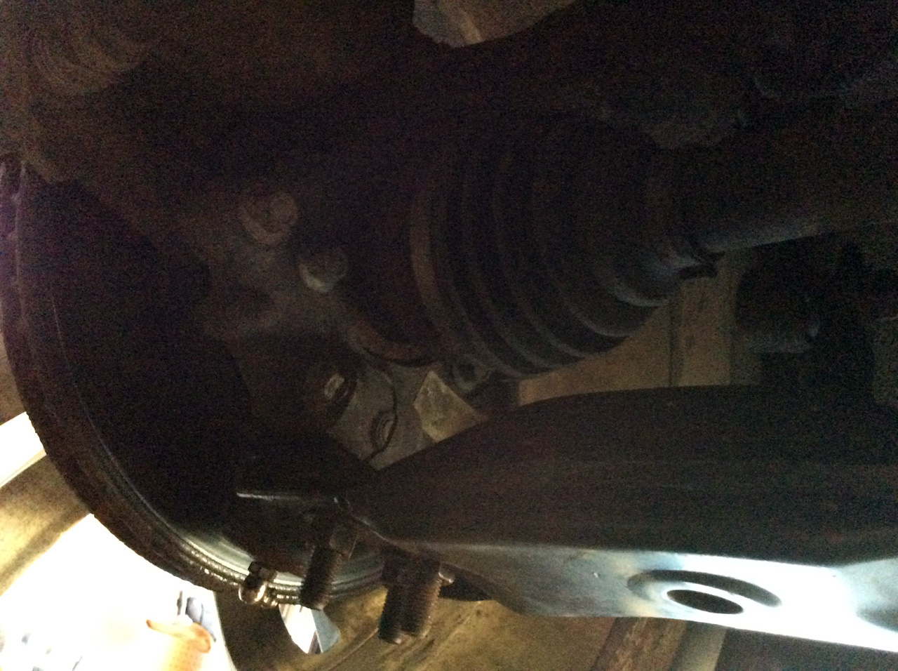

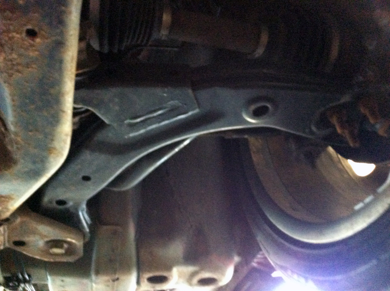

Darn, just noticed stamped steel LCA's. 724, 725's should be aluminum from what I've read. Not sure if they replaced the knuckle so the different 20 mm stud would fit from the LE1, LE3 suspendion. If it is the FE5 knuckle, I'm thinking it could be ruined? Well those are going in the $**T can and the new correct ones going in. Probably get new knuckles to be sure. These must have been put in a long time ago from the looks of it. They didn't know or decided to go the unsafe cheap route. This doesn't look like too bad of a job to do in my garage.
If you see anything wrong here, please correct me.
Thanks
Thanks
You have stamped steel LCA's in your SS? Their incorrect, closely inspect the knuckle for cracks , if they tried to tighten the ball joint pinch bolts , they could have damaged the knuckles!

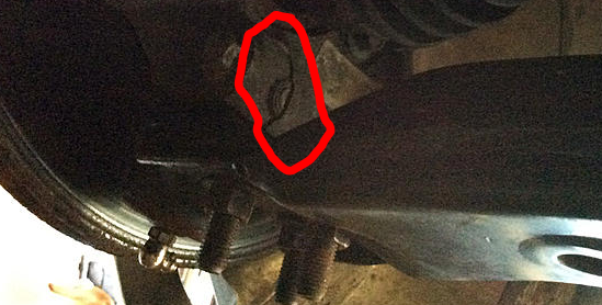

I am not sure if this is a crack or not.
