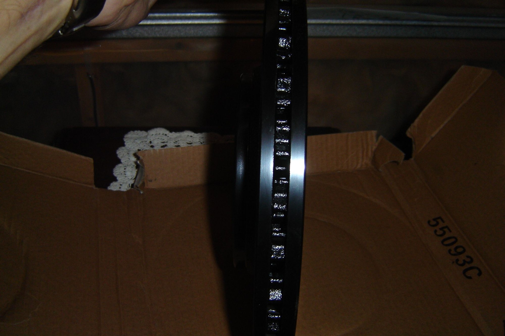

Where do you get non-vented rotors? I've never seen solid rotors.

My rotors are vented
Coated for rust protection between the rotor discs
Coated for rust prevention inside the hat
The braking surfaces are ground and not cut leaving grooves

The rear discs for the SS model is a solid disc
