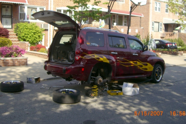

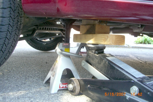

Hardest part for me was jacking up the car enough to get the jack stands in place. First, I tried under the rear sway bar. But, could not get enough height from my jack (I think it needs hydrolic fluid). Next, I did it in front of the wheels, but needed to use 3 2x4's.

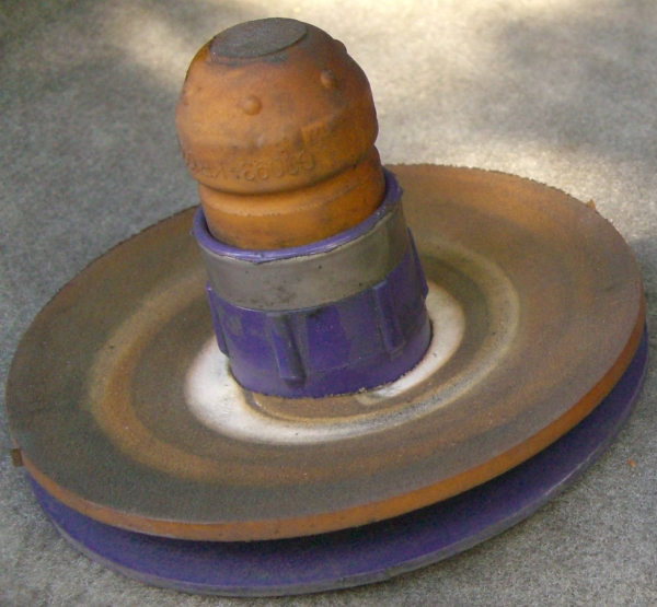

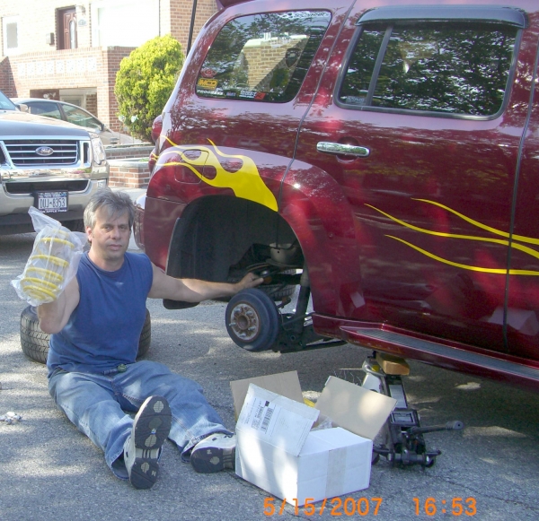

Once both sides were up, the springs came right out (the bump stops were what was holding the springs in).
The car went back together easyily afterward.
The car definitly feels a bit stiffer. I only drove it to the car show tonight, so will get a better taste of it tomorrow.
I did not cut anything off the bump stops, because I was not sure where. The diagram in the instructions shows rubber at the top, but there was hardly any on ours. The only place I could imagine would be the part that goes inside the spring, where if the spring fully compressed, it would hit the other end. But, I doubt the spring could/would compress that much. Hope not, anyways.

Something's definitely messed up with the jack. Should have been able to get more height than that.
Did you place the jack stands on the scissor jack flange?

Nope-seemed too narrow. I put them under the bolt by the reinforced part of the subframe. And I jacked up the car right in front of that bolt. Seemed to work great.
Thanks for that info. I have not had an opportunity yet to look at places where jack stands can be safely used on the HHR; I've just been observing pics from folks here to get an idea where they are putting them.
