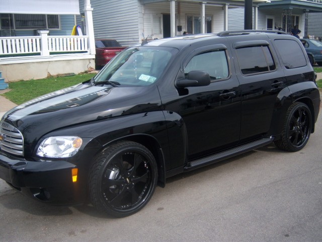

Appearance - The springs on day one have settled to 1-3/8” drop in the rear, and I have been told to expect a little more as they really settle in. The car looks soooo much better to my eyes. It is now level, not raked with the rear end in the air. As someone said, it used to look like a stink bug.
Before.....
After.......
Before.....
After.......
