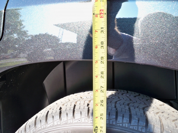

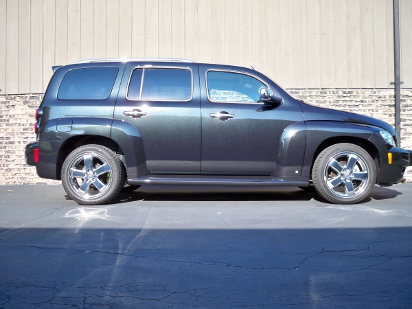

I just finished swapping the stock rear springs with 08 Cobalt SS rears, P/N 25821162. The swap is easy and gave me exactly a 1" drop. I'm hoping to be able to download all the pictures to this thread.
The springs, while standing next to each other are 1" different in height and that held true after installing them. I tried to use a crude micrometer to measure the thickness of each spring. The stock HHR springs seems very slightly thicker than the Cobalt, maybe 1/32".
I've only driven the car a short distance but already like the ride. It doesn't seem to ride so much on top of the spring, and not so bouncy, as if the HHR spring was ready for more load. The ride in general seems smoother over small bumps. And, no noises so far. I already installed TT's rear sway bar and am very happy with the combination.
OK! I've tried 3 times to upload pictures to the gallery. It gets 50% complete then stalls and times out. I don't know if the site is having problems or what. I'll keep trying. GOD I HATE COMPUTERS!! I didn't see a way to add the pictures directly to this thread, like I had intended.

So far I've loaded 4 pictures to the Members Gallery. Thanks for getting the first 2 into this thread. I seem to be having problems loading the picture showing the new 28" height and one of the springs side by side. The full car picture you pulled into this thread looks like the new height. Please go to the gallery and you should see a full car picture that has the original 29" height. You should be able to tell the difference. Thanks for the help.

Here are the before and after pictures altmanglen wanted to show everyone:
The first two pictures look the same, I can see the difference in the last two pictures.

Mr Vette, Thanks for helping with the pictures. I mistakenly loaded the 29" picture twice. Now I'm having a problem getting the 28" measurement to upload. The full car pictures tell the story. The first one above is with the Cobalt SS springs, the second with the stock springs. It's pretty easy to see the 1" less open space above the rear tire. I think it's most noticeable looking at the rocker panel being level now in the first picture.
