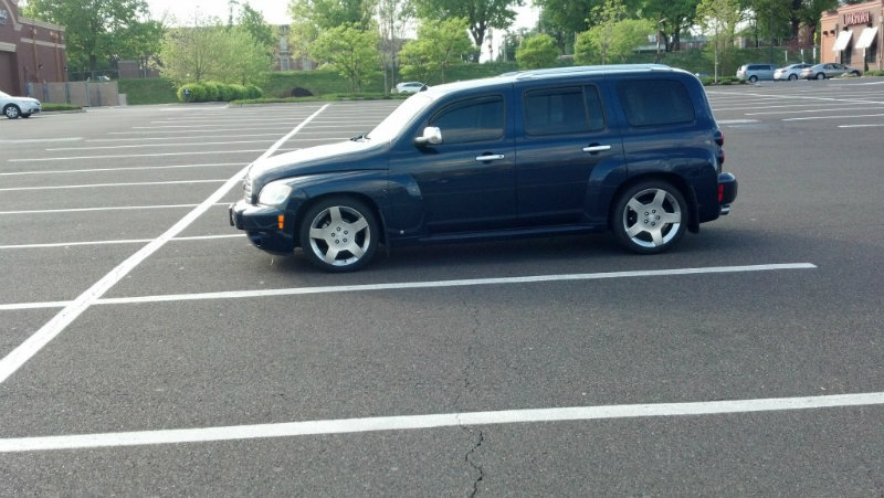

There are a few people on here with Eibach springs and they have no complaints. I personally went with 06-07 Cobalt SS/SC struts and springs. Paid $200.00 for the complete setup. Here is a pic of my drop.
Forgot to mention, make sure you get the Camber kit. I needed them for my HHR, my alignment would not get into specs without it.
