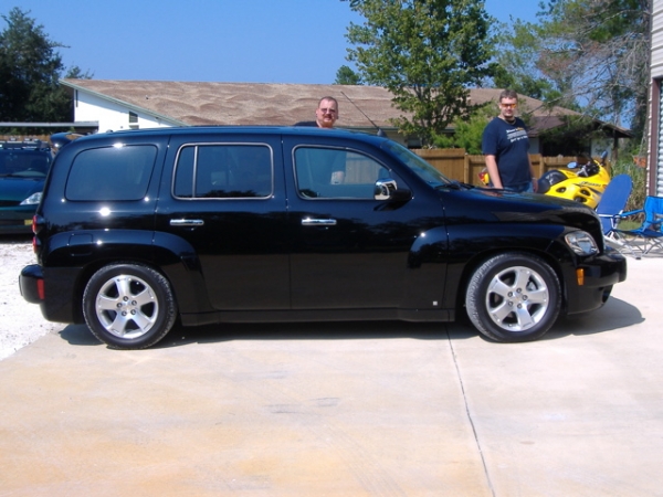

Don't know where/who started gen 3, unless whoever started it was referring to the leveling kit, but here's an illustrated version........
First gen.......
Second gen........(1LT on the left, 2LT on the right)
Originally Posted by 1Panel2NV
I originally thought they were gen three, but I'm not 100% sure. The part number was 1262.
This is the part number listed on the box my set came in. I had just missed out on the 1st gen. Dory is the one on the right in the second picture illustrating the 2nd gen GLs.

I'm not sure. I guess I could try contacting goldline to find out for sure. To me, it looks like both the HHR's in your picture are lower in the front. I've seen scaleguy's HHR in person and he has first gen, but mine is not that low, but is still level. All I know is that I'd rather have first gen.
