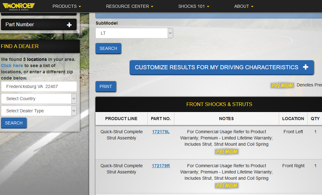

The part number may be the same but, for Quik Struts it is followed by a L or R it is the direction of the coil . If you re use the old springs they are the same, but the springs are R & L.
