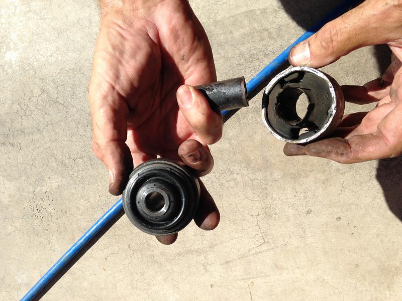

For the LCA the rear bushing could be one of your clunks, the one on the right was deemed just fine at my GM shop, said I just needed an alignment, well it don't look to healthy to me, I used a ball joint press to change them with Moog K200792 problem solvers, and while I was down and dirty, changed out the swaybar end links with Moogs also,

I drilled through first and chiseled the head off. I believe it's a better way to address the ball joints after replacing the Moog K200792 problem solvers rear bushings, no more brake judder either!
