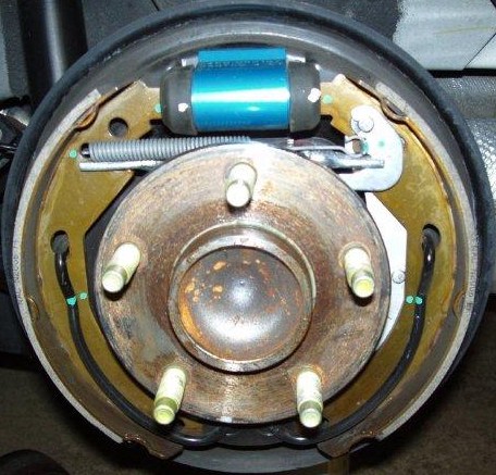

X 3, (see pic) the backing plates likely need a light thin smear of approved Hi-Temp grease. Only 4 points of contact per side.
This can be done with only removing the drums, 1st clean brakes & drum (as previously noted) then use a thin blade screwdriver to gently pry up each brake shoe, them use something thin (I use a feeler gauge) with a tad of grease on it...Wipe it on the backing plate where it contacts the shoe.
This is a case of more grease is NOT better.. once done adjust brakes properly,
reassemble & enjoy..

Thanks you for the replies and the pic Sleeper. I dont have a lot of rear break experience so this information means a lot to me. I will report back in the next few days with the results.

NorthernMike-
Use caution when cleaning the brake dust off. You can even use a spray water bottle (with water) to spray the brake dust off & into a pan under it..
Don't want to breathe any of the dust,..
Adjusting: I wind them up till they sprag lightly, then back off 1 click.
This also helps keep the front pads & rotors living longer..
