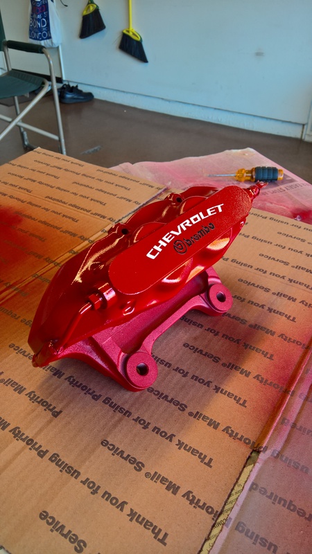

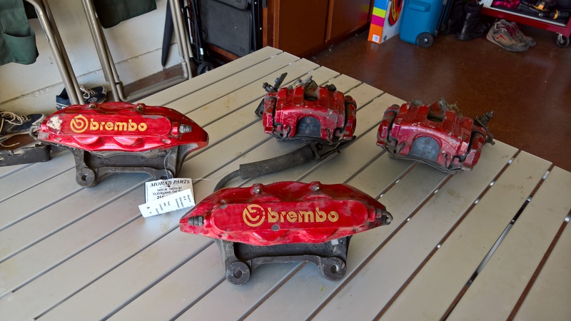

Hello all! I bought a brembo set off ebay that came off a 2008 Cobalt SS with aftermarket rotors. The brakes were chipping and I have decided to repaint them.

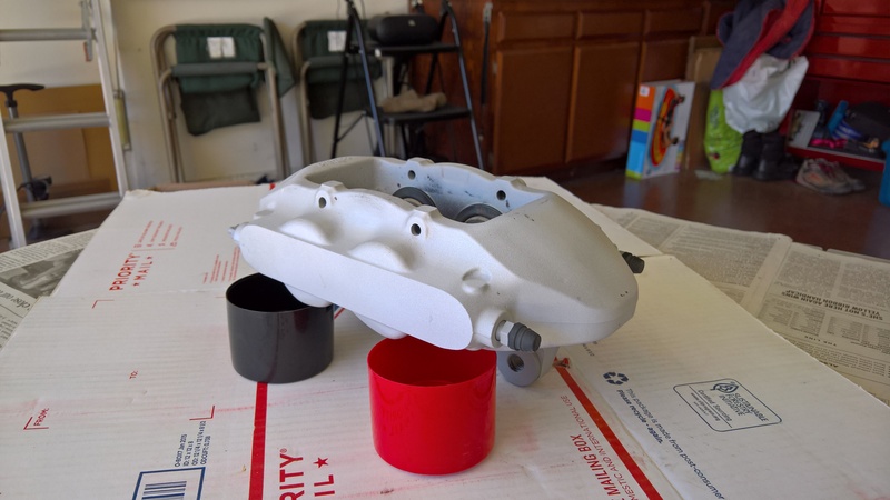

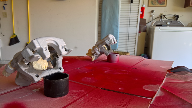

Got them sand blasted to make sure they would stick the best.

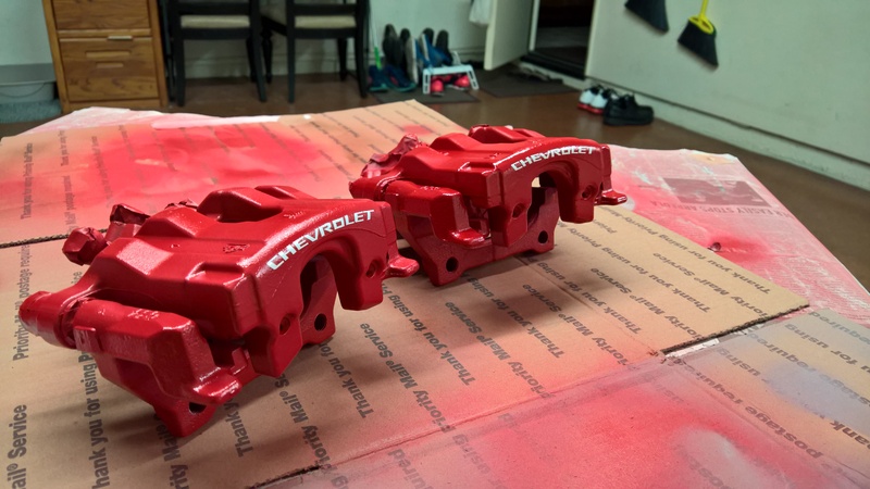

Decided to buy new vinyl brembo stickers the one that came on the Camaro's Looks great!

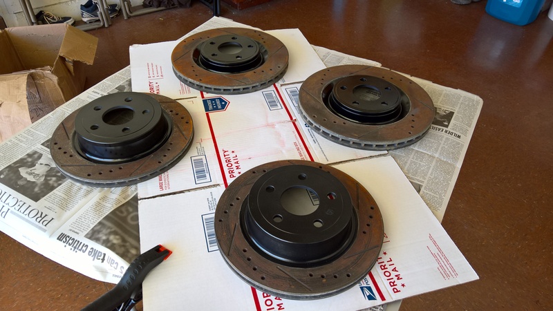

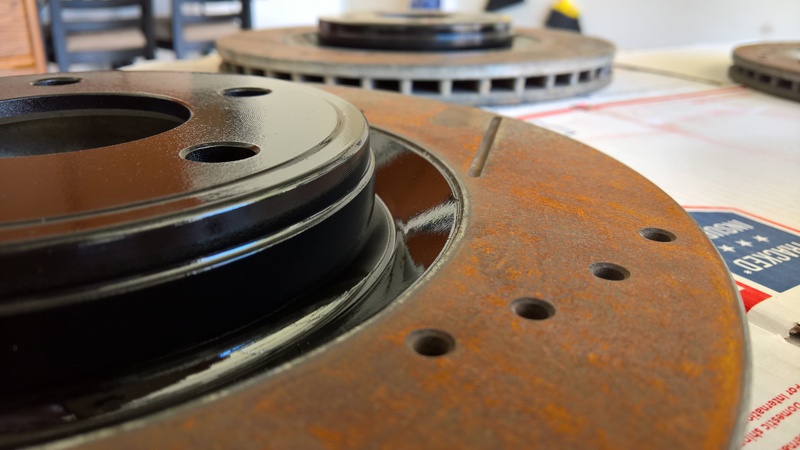

Also Painted my rotor hats.

Old Jul 22, 2016 | 06:12 AM
Posts: 40,083

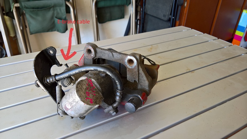

Very neat job!! So the rears calipers, do they bolt up?
Old Jul 22, 2016 | 07:24 AM
Posts: 26,533
Those rear hats look a whole lot like they want shoes inside for E-brake. Or, is that the way they all are?
I'm going to bolt them up as soon as I can. They have the same mounting bracket as the old one so I am hoping.
They are identical to the rotors I have on he cars now. What makes them look different?
I think the caliper is used for the parking brake, not a separate shoe.
Old Jul 22, 2016 | 02:21 PM
Posts: 40,083
I didn't see where the ebrake cable connects to the rear caliper, so I thought the same as Don! a drum style ebrake and disc brakes

Posts: 11,721
Based on the pictures in the OP's other thread, I still don't see that these are going to just "bolt up". Especially don't see the e-brake cable connection being compatible.
The other thread: https://www.chevyhhr.net/forums/brak...-hhr-ss-57304/
Anyhow. Good job on the paint work.
Old Jul 22, 2016 | 02:40 PM
Posts: 40,083
I'm looking for the rear of the caliper style ebrake cable like these
I didn't see the place the red arrow points. I feel better now, thanks
