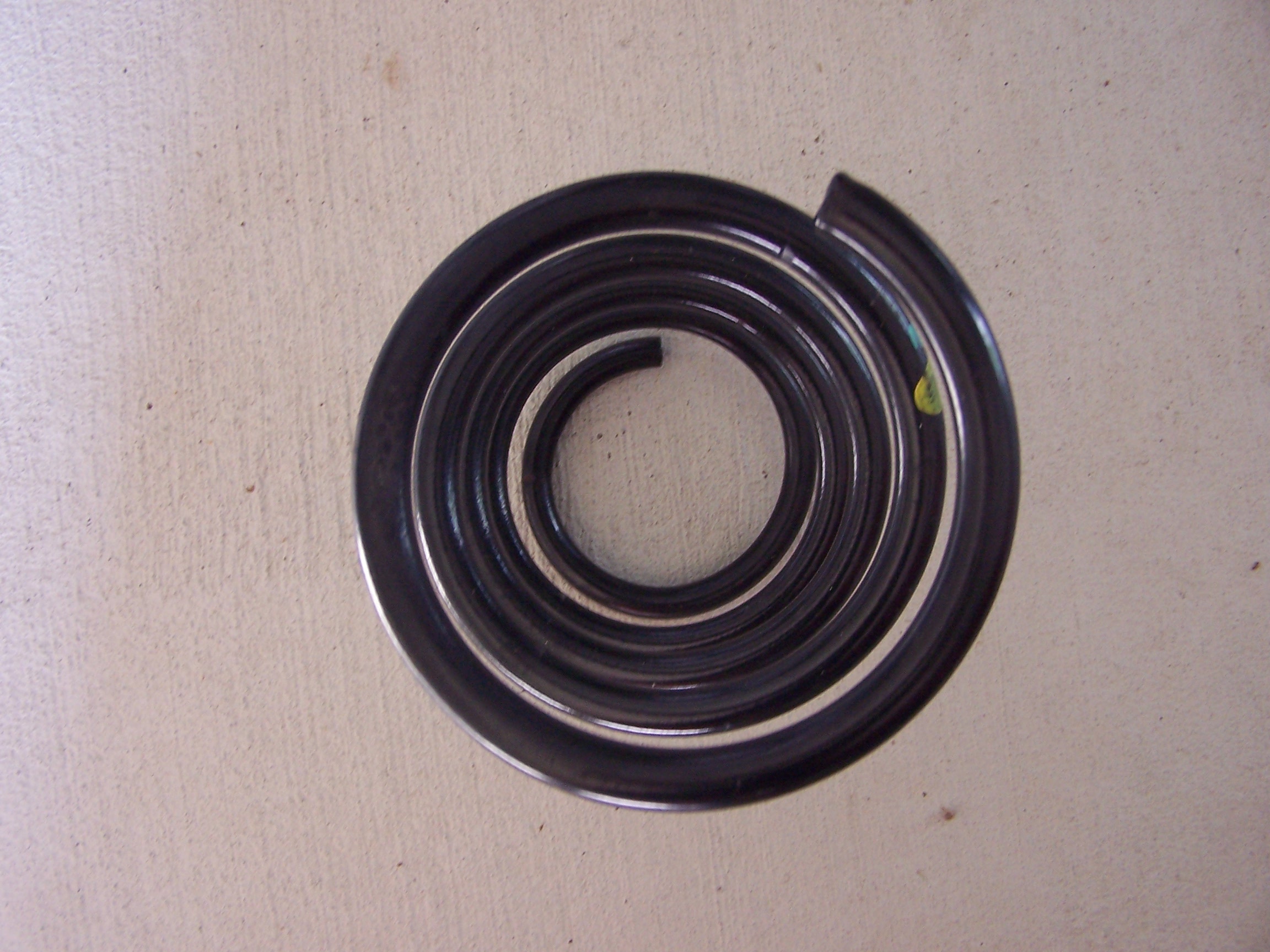

Correct Oldblue.
I guess it's just the angle of our picture(s) that can be misleading. One coil wrap on one end of the front springs is a little smaller.
Here's a different angle shot.

It's been 5 years since I installed the Canucks but I do recall the smaller top winding.
Now according to Don's compatible chart, it's a matter of install and hope for the best!
In the OP's case I'd order front springs for a diesel model as the spring rate should be higher
