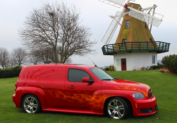

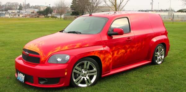

Got it aligned today, wiped her down and took a couple pictures to share
Rides like a dream, it is a slot car on the road

Sweet. Looks like a little more than 1 1/2" drop from stock height. 2" maybe?

It is an inch lower in the back & 3/8 in the front from what the Pedders were, but the ride is awesome, I wish I'd done this in the first place.

So roughly 2 1/2 in back and about 2 in front from stock. Should be just about equal, front and rear measurement, ground to fender lip. Awesome.
Wish I could go this route but pretty much I can't get any lower than the Pedders. Wouldn't be able to park it in my shop where I keep it. Concrete ramp is a little too steep.

From the bottom center of the rim to the rear fender is 23.25 & the front is 23, I want to go lower, I still have alot of adjustment in the front but I'm maxed out in the rear, I'm sending them a picture and heights to see I can get a shorter spring, I'd like another 1/2" in the rear.

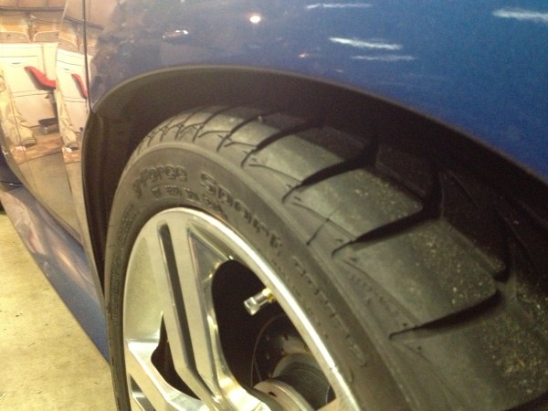

That is exactly where mine is too . here is the rear with 245x40 a little shorter tire, mine is all the way down in the rear too, thought about removing the adjuster and use the spring top plug, easy 3/8"
