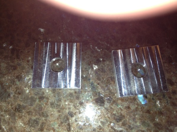

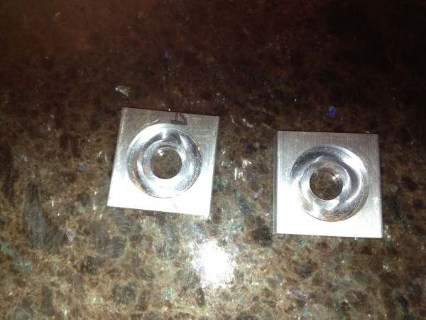

Old Jul 9, 2013 | 09:54 PM
Will you make me some of them shims, I lost mine. They looked like this
Old Jul 10, 2013 | 11:40 AM
IgottaWoody's Avatar
Joined: 01-13-2008
Posts: 4,708
look easy enough.....havnt climbed under yet to have a look see
