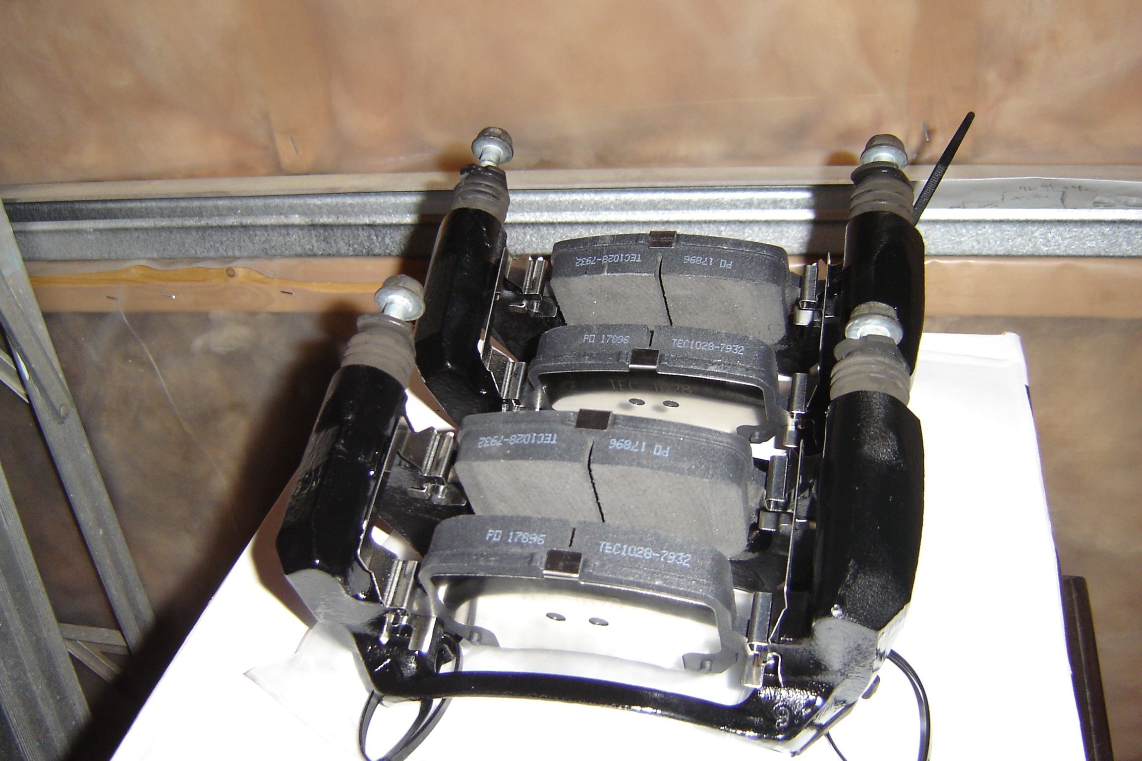

Old Mar 24, 2016 | 10:12 AM
Posts: 40,083
I followed Solman98's thread, the SS setup fits in 16" rims

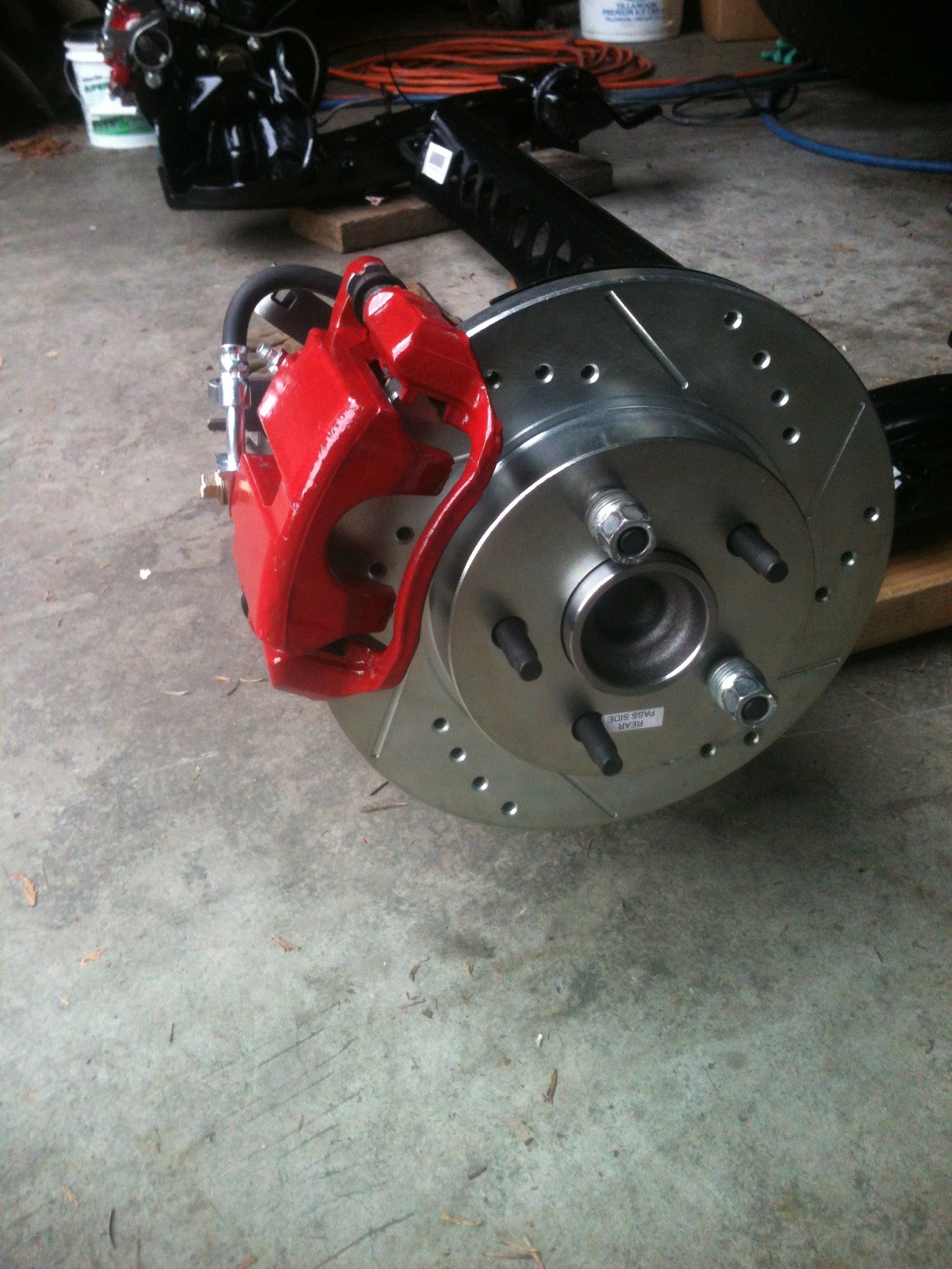

Old Mar 24, 2016 | 11:03 AM
RF2's Avatar
RF2
Joined: 10-14-2012
Posts: 200
From: Washington P/L
Don't forget to upgrade the back too.
