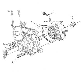

FWIW: Axle nut torques to 81 ft lbs, & hub bearing bolts (3) torque to 85 ft lbs.
