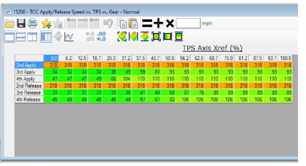

Here is the Apply-Release programming. It's based on MPH and Throttle position. Should help figuring it out.

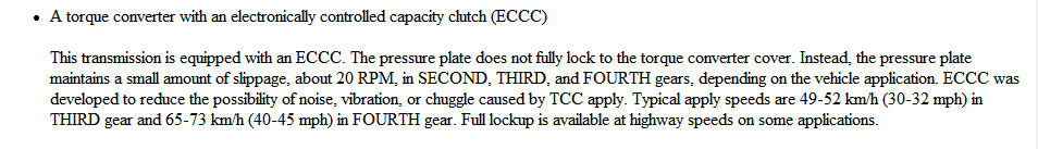

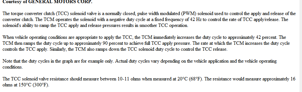

Here are a couple of bits from GM that might help:

Also good information. The newer PWM apply makes it much smoother.
