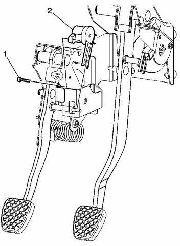

One thing I don't understand here. If the clutch pedal is stuck down, you should be able to start it in neutral. ( you said above that it won't start)
Yes, the "computer" would recognize the clutch as being depressed because the Pedal Position Sensor(PPS) is at the top of the clutch pedal.
The only reason I can see that it wouldn't start is if something has broken on the pedal assembly itself.
If you have a bad clutch assembly, master cylinder, or slave cylinder, you should still be able to start the car.
I would be taking a look at the clutch pedal area first.
PPS #2

On the way to work yesterday I stopped to have a look at the clutch pedal assembly to see if something had broken or come apart as per the advice of FiremanGeorge. I get in there with the flashlight and give a light tug on the clutch pedal and SPROING!! the clutch pedal snaps right back into position!
I give the pedal another push and it seems to be working normally again. I sit in the driver's seat, push on the clutch, turn the key and she fires right up and shifts normally. Problem solved. Guess I should have tried that moment it happened! Pretty embarrassed about that . For a guy who has the mechanical ability to convert his Volvo 940 Turbo from an automatic to a manual, that's pretty humbling and at the same time kind of comical to have not tried that before going off all mad and ranting about the car's quality on this forum.

Don't assume it won't happen again. This happened to me also. Check the center bushing for the clutch pedal return spring. Mine was cracked, yours may be cracked also. Now the clutch pedal arm rubs metal to metal on the clutch return spring. I had quite a groove worn in both the arm and the spring. I bought the spring kit, filled the groove in the arm with epoxy, carefully filing away the excess epoxy, and installed the spring kit. Problem solved. Cover your floor mats so epoxy doesn't drip on them.
