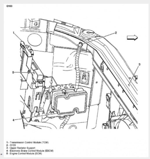

Old Jul 29, 2024 | 07:12 PM
Posts: 40,083
#2 is the ground cable on the rad cradle

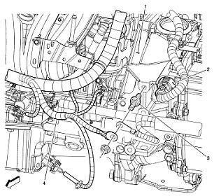

Here’s the 2 ground cables to the transmission
