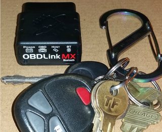

That's why I eventually bought an OBDII reader. Guy at the counter of O Riley's told me it was probably throwing "pending" codes, & that the car wouldn't be able to show a code after engine was shut off because it's not happening frequent enough to be pushed to CEL priority.
As soon as I got my reader, I was able to catch a pending code as my stalling problem happened again. it indicated a problem with the upstream O2 sensor, and was gone next time I started up the car. I replaced the sensor & that problem disappeared... only to have worse problems pop up 3 weeks later which led to me buying the HHR!!!
Just got a new reader: OBDLink MX Bluetooth (available in WiFi version for iOS devices) and it's much better than the one I had originally bought. $100, but comes with software (via download) for your phone / PC & is well worth it IMO. Of course you can spend a lot more & get something like the ones they use at Autozone, Pep Boys, OReily, etc..., but this one's simple, tiny, & uses your phone or PC to display the info instead of a built-in screen.
Here's the reader next to my keys (for scale)
I just plug it into the OBDII interface before I start my day, start up Torque Pro on my phone then go. At the end of the day I unplug the reader - though theoretically, you could leave it plugged in 24/7 However, it is powered on as long as it's connected, and continues to send a signal out over Bluetooth even if your phone / PC / laptop is not close enough to receive...

Now those are way to many keys on that FOB for an HHR! But the reader is a nice easy to use piece.
It also looks like your FOB is ready for a replacement key pad! Like this case and pad,
