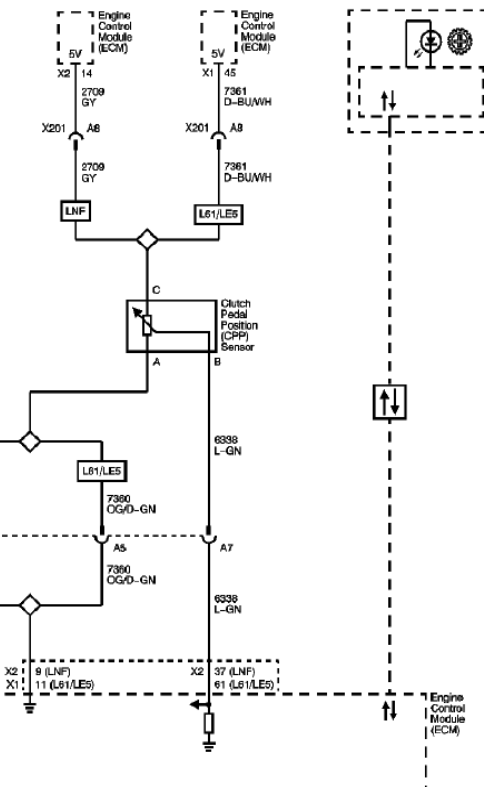

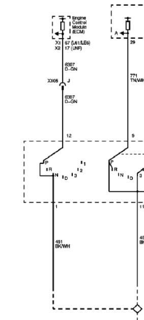

Did you wire in the clutch pedal position sensor? That is required to replace the park/Neutral switch on the auto for starting. I guess you could probably just short the wires as a proof of concept. The D-GN wire in the TCM harness should go to ground to enable starting, if it was a 5-speed the CPP would be a L-GN wire. (I think). Actually, that wire goes to the ECM, on an auto it goes to X1/pin 67 on a 5 speed it is X1/pin 45

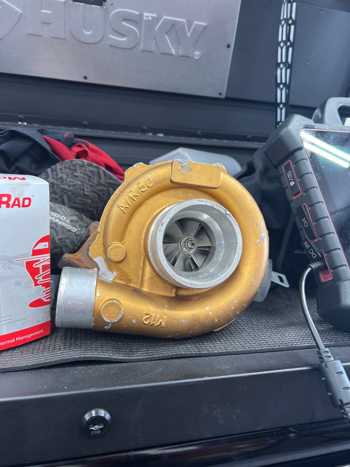

I hope that pic is not implying your next project is a turbo in a LT. That will be even more involved and possibly fatal to the engine.

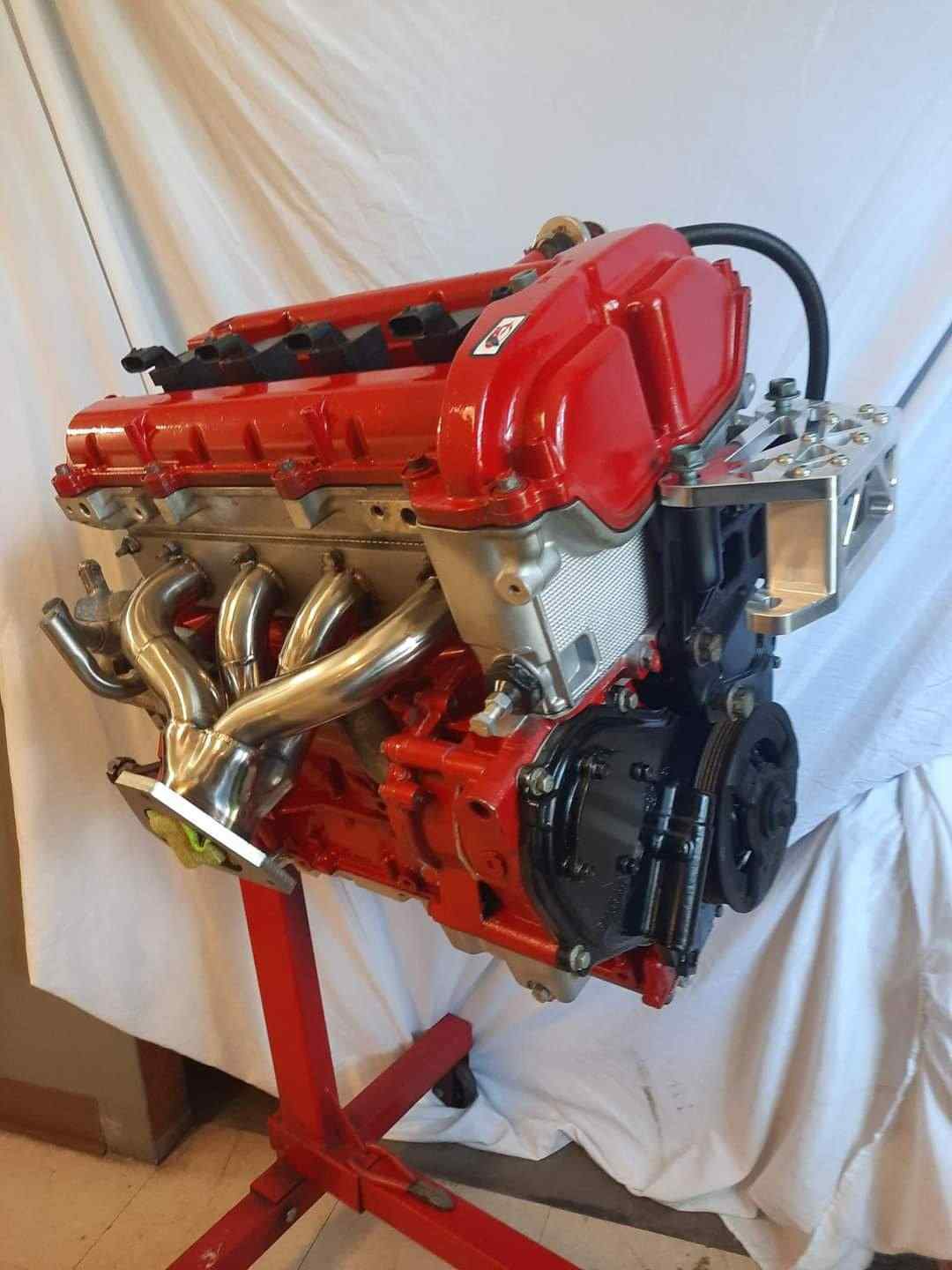

Is not fatal for the engine I figured out thank and yes that is my next project the only one in my area manual trans whit turbo at least 25 psi thank for your help this is another pic for the engine I have too many year of this industry this I do for leaving
