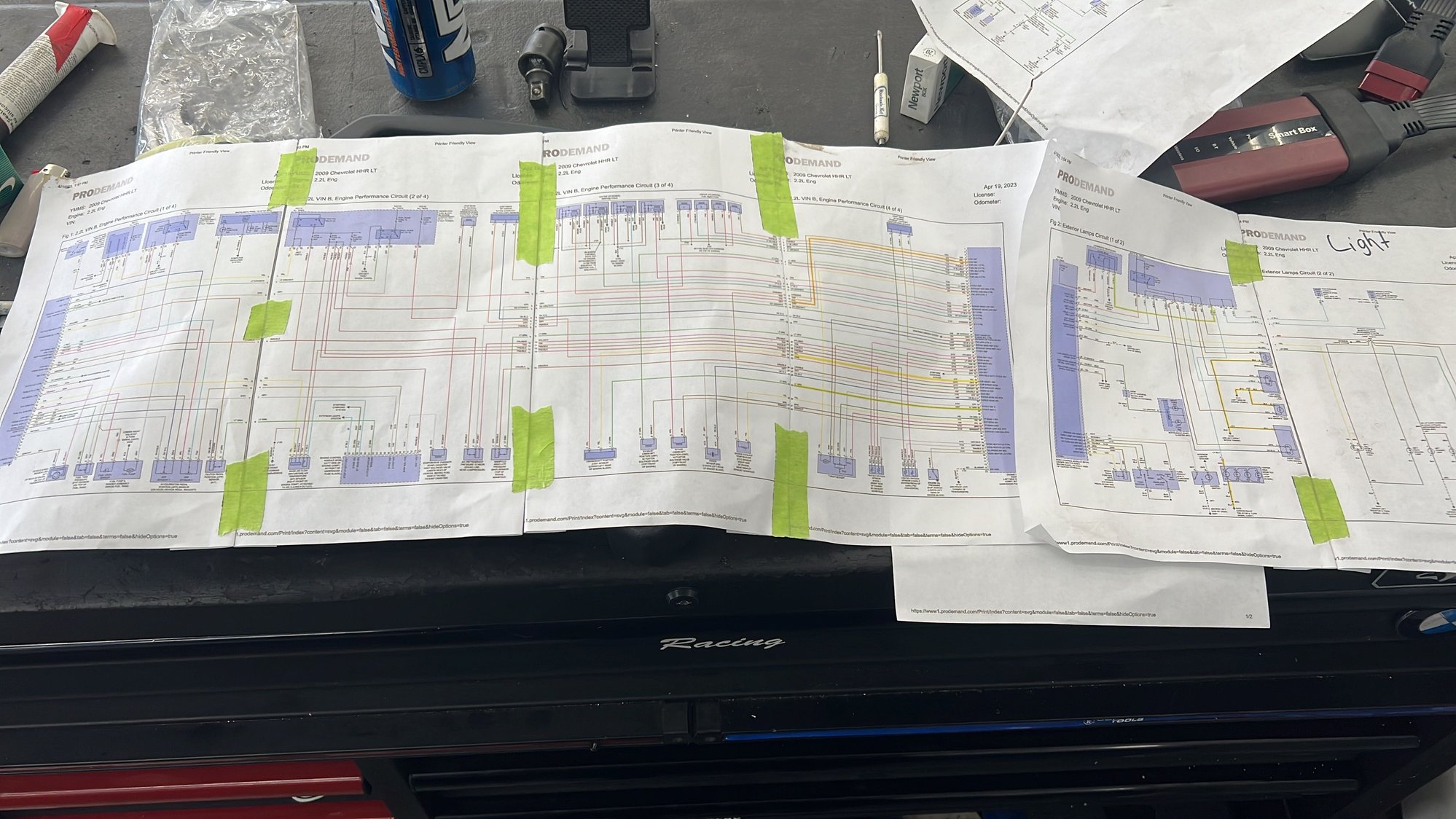

Originally Posted by donbrew
Well, ok then, why not compose a how to for our how-to library.
I will
Follow diagram
First setup
Fully adjustable
Quick release

Im not sure if you got it figured out yet, but the harness/computer isnt your issue. You need to put the gear selector in neutral and raise the neutral rev limiter to redline
You don't need a TCM with a standard trans. The RPM is being limited because the TCM thinks the trans is in park, with no input.
tcm com wires need to be looped at the tcm and at the front tranny plug
