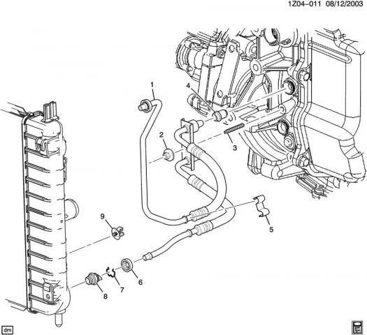

Hello I am trying to figure out how to remove and instal part #4 on my cavalier. Has any one done this before.

Yes, I have , they can be pried out with patience, not much room to work a pair of medium vise grips to clamp on and wiggle, wiggle, wiggle. Some help from a small pry bar .
I greased the seal and the transmission housing and tapped them in with a socket .
Not a fun job.
there’s a Kent Moore tool for the job

The seals are the same in the 4T40E automatic, and I got the thread moved FMG , sorry I was having a cold beverage and barbecuing steaks.
