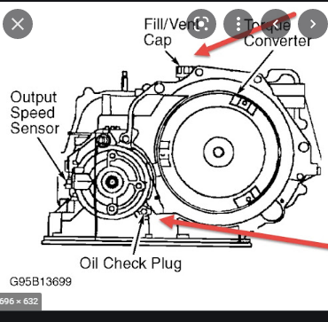

Old Aug 24, 2021 | 05:24 PM
  #48
Posts: 26,533
Originally Posted by Kokomo
The transmission fluid was changed about a month ago, Getting to that fill plug was awful since I have big hands, and whoever came up with the bolt instead of just using a dipstick like everyone else needs a swift kick in the jewels. Fluid that was drained out was probably original, very black but no metal shavings just normal wear and tear it seems.
The filler is the big plastic nut looking thing on the top of the trans. The level control is the bolt on the side; it should barely drip (engine on, warm and level).
Why would you need a dipstick? Don't you ever look where the car was parked? The ATF has nowhere to go but the ground.
Old Aug 24, 2021 | 08:43 PM
  #49
Just another HHR tranny pic.
Or the radiator...
