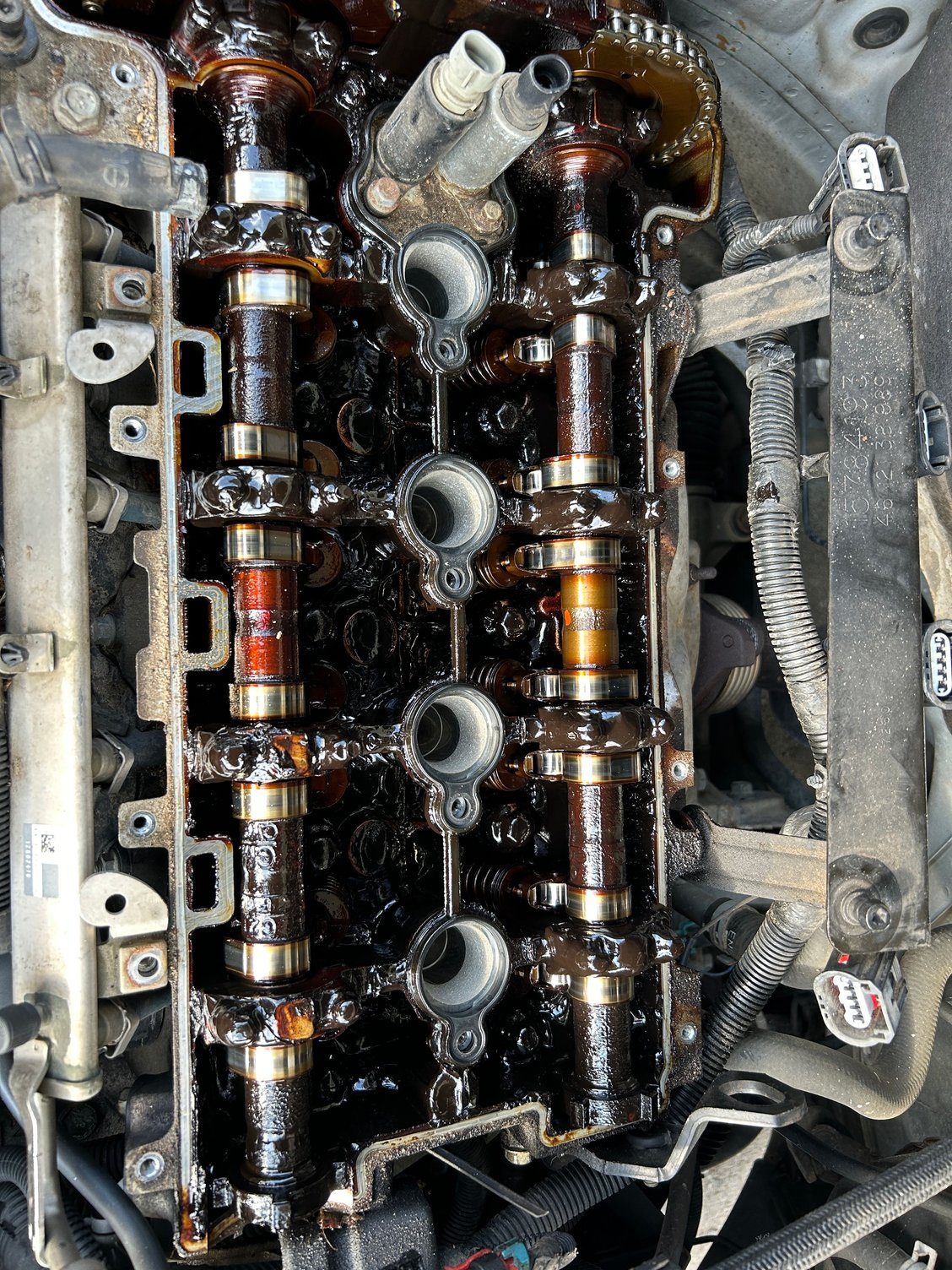

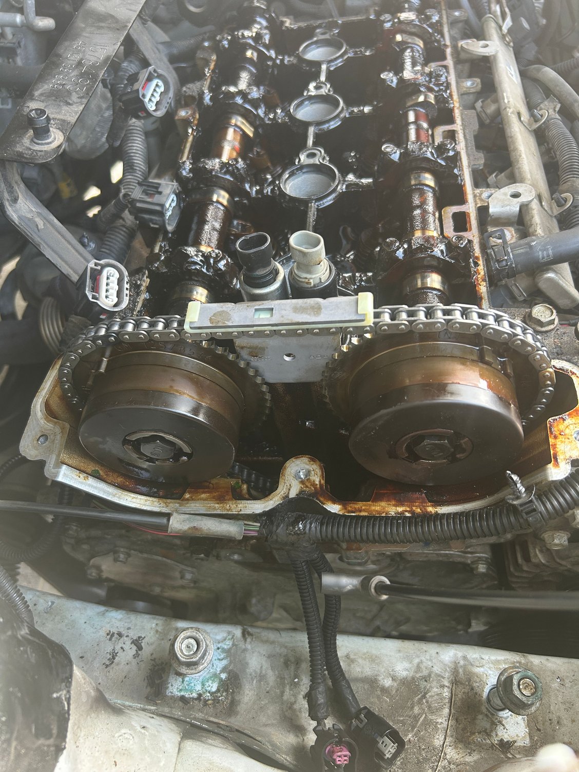

Timing chain tensioner has been activated. Turning clockwise only except a little counter clockwise to adjust give me chain slack when I needed it. Attached are pictures showing cams at 10 & 2 oclock positions. I have the timing cover on now but the crank timing dot is at 5 oclock. If you see anything out of sorts please let me know.
. Colored links don't match because I've been turning the crank by hand.

Cam lobes appear correct position.

I do notice that the exhaust cam lobes appear to be opening the exhaust valves a little.No sure if you can see that in the pictures or not.
