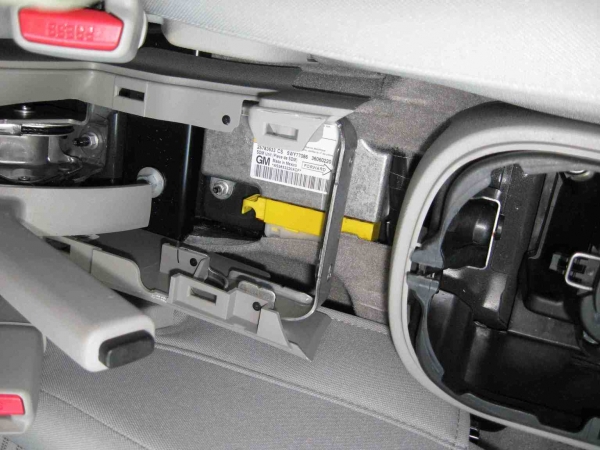

Originally Posted by Smoke Wagon
one has to fully understand how airbag sensors function before expecting them to deploy at any major impact.
in simple terms, air bag sensors basically work with a ball-bearing attached to a spring inside a tube. The weight of the ball-bearing causes the spring to expand during deceleration. The spring has to expand a certain distance to allow the ball bearing to make contact with the end of the tube. In a side impact, the ball bearing has to extend the spring far enough to the side to make contact with the tube to ignite the side air bags. If this occurs, the air bag will deploy. so speed, inertia, rate of deceleration, and direction of momentum all play a role in whether or not the air bags will trigger. remember, these cars have 2nd generation air bags now...they dont ignite/deploy as easily, or as forcefully as the 1st gen airbags used to.
Bottom line is this-if the air bags did not deploy, they were not suupposed to deploy in that type of accident.
GM has long been at the forefront of airbag technology, and the current generation of sensors are far more complex. The Sensing & Diagnostic Module (SDM, sometimes called the 'black box'), located on the tunnel under the handbrake, records a lot of data from the vehicle, the accelerometers within it and around the vehicle periphery. The deceleration is detected by tiny electronic accelerometers, and I'd assume that in a vehicle with side airbags, there'll be lateral as well as longitudinal accelerometers. Whenever there's an airbag deployment, the data is recorded into non-volatile memory, allowing it to be recovered later by diagnostic equipment - http://www.boschdiagnostics.com/test...s/CDR_faqs.pdf
I'm not sure whether the data can be retrieved by the regular scan equipment, but the insurance company may have access to it through crash reconstruction experts. Near-deployment events are also recorded in erasable memory, but should be accessible for some time. There's been a lot of discussion about this in the Corvette/F-body communities, since the data recorded can be/has been used for evidence in prosecutions.
Even armed with this data, you as an individual still can't determine whether the system operated as intended, as the algorithms that GM has developed as a result of crash tests and real-world data from wrecked vehicles, to determine when the airbags should deploy, is closely guarded.
http://www-nrd.nhtsa.dot.gov/edr-sit...ms_by_TARO.pdf
http://www.rdaweb.com/Newsletters/airbags1.pdf
http://www-nrd.nhtsa.dot.gov/edr-sit...--Corvette.pdf
http://findarticles.com/p/articles/m..._n8986421/pg_1
http://www.chiroweb.com/archives/19/22/02.html
http://www.nhtsa.dot.gov/cars/proble.../chidester.htm

pg318
thank you for taking my "5th grader explanation" which is about the extent of my air bag knowledge, and explaining it in detail.
I can now understand more about GM's reputable "black box", which has long been a topic for debate amoung(you guessed it) Corvette owners.
seriously...awesome explanation.
Is the "box" you speak of the one located directly below the cup-holer area of the console, seen here?
cuz if it is...that's a whole lotta wires goin' in.
Old Feb 21, 2008 | 09:04 PM
pg318's Avatar
Joined: 11-11-2007
Posts: 364
From: Sheboygan WI
That's the one, all the airbag-related connectors are color-coded yellow. They're always bolted solidly to the bodywork, to accurately transmit a representative acceleration of the passenger seats to the sensor.
