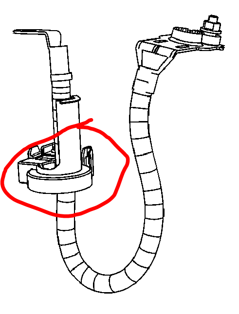

What voltage is the alternator putting out? VOM on the battery engine off reads battery voltage engine on reads alternator voltage. Battery should be above 12.6, alternator varies between 12.6 and 14 volts depending on demand.
Did someone remove/disconnect the piece of plastic that lives on the negative battery cable? That is the sensor that controls the alternator.

I will check the voltages tomorrow. No, no one removed the plastic piece on the negative battery cable. Assuming you are talking about the ring like thing that the neg cable goes through? I do have two amplifiers for the stereo but i've disconnected them in the past just to see if there was any difference and there wasn't. I have a hunch that battery may be the culprit and I know the amplifiers can wreak havoc on plain jane batteries. Battery is about 3-4 years old and it's just a wal-mart special. I will post back with voltages tomorrow. thank you
