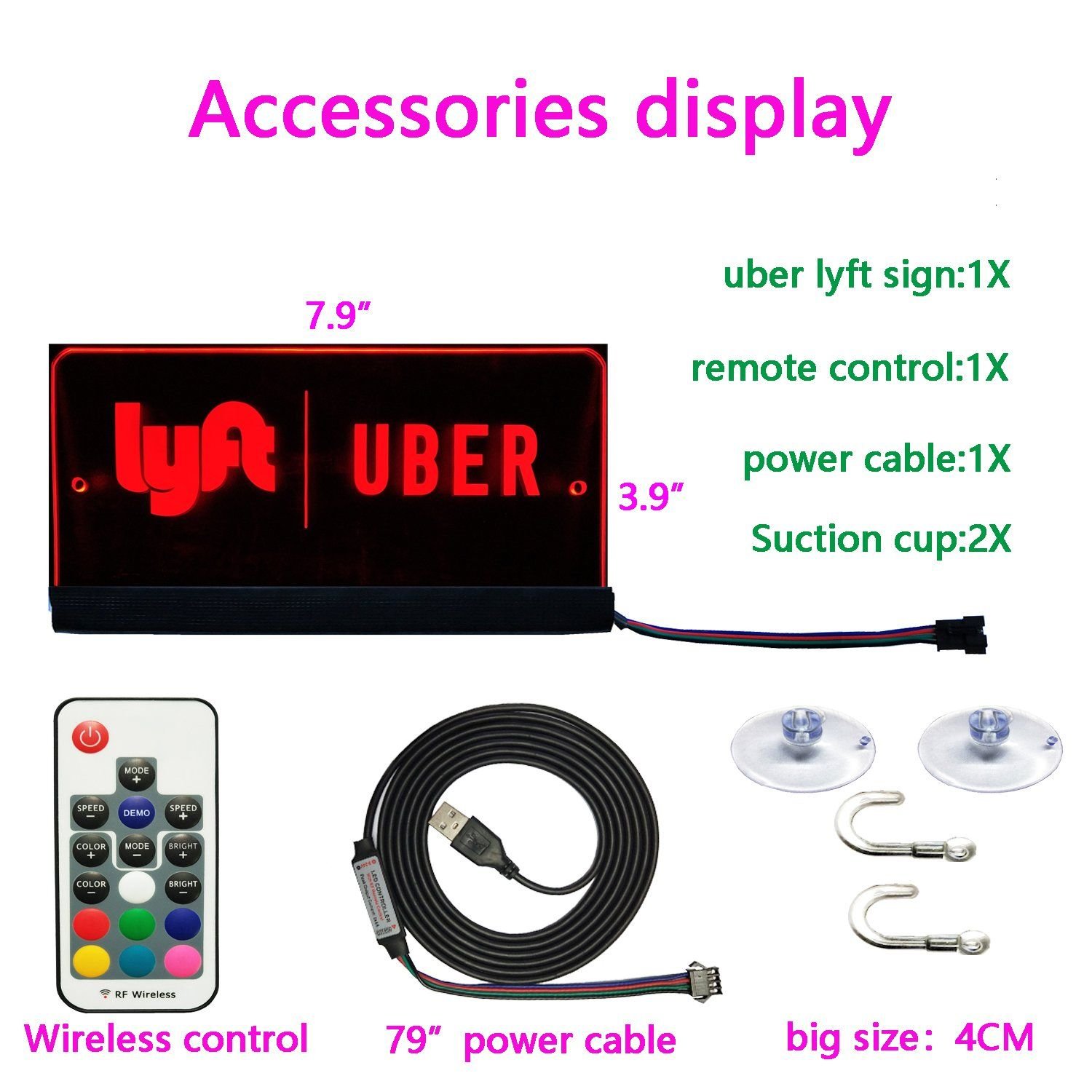

hey all,
i'm wondering what the best way to wire a rear LED sign to my 2011 HHR LT would be? do i route a wire to the rear cigarette lighter? if so, how do i protect/conceal the wire from passenger feet? should i tap into a wire in the rear of the car—sign is operated by remote, so constant power is desired? if so, can anyone recommend an easy tap on the passenger side ideally? the sign is a 4 wire R,G,B,Black LED control that normally connects via USB to a lighter adapter.
thanks.

Can you show the product you would like to use ?

here's the best picture without taking a photo of mine which is now wrapped to bind the 4 wires together:
Amazon Amazon

I myself can't think of a 12 volt constant supply at the back of the car . Being that you have to use that type of connection with this the only thing I can say is yes, your going to have to use a constant power source that doesn't interfere with the Can Bus wiring.
Sorry I can't be more help than this.

i'm happy to run a wire under the back seats and carpet and come up inside the middle dash assembly (drill exit hole for cord to enter cigarette lighter, but i think i'd need to route it under the carpet. having tried in the past to remove my rear seats, it's a pain in the #&@$ and makes it impossible to reattach the plastic lower bolt covers. any threads you know of that deal any routing like this?

To begin, the unit in the picture has a USB connector. That is 5Volts not 12Volts, so you are going to need a USB adapter, not a cellphone charger.
Once you figure that part out the battery is right below the hatch next to the spare tire. Just splice a fuse in.

As per Donbrew's recommendation - something like this wired to the battery under the rear floor will work to give you the 5V needed for the USB connector. However you will need a switch to turn it off as I would think it draws power even when the car is turned off.
Amazon Amazon
Did the kit not also come with an installation guide?

If you can't just do it a remedial course is not the solution. Seek a professional installer, there must be window tint/radio/security system shops near you.
Not denigrating your skills, if it is not in your wheelhouse it is not in your wheelhouse and there are people that make a living doing it.
Earlier I said "not a phone charger" Strike the "not" that is exactly what you need.
