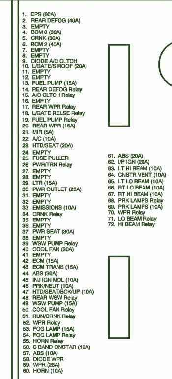

Don Thanks., After the swap they did pop a fuse. I do not know which one but said it was a bad starter so they replaced it. Car ran fine for a month or so and then would not start , Fuse again ! I assume the same one I changed ! When I removed the bad fuse I did do a Ohm test and it was NG. Replaced and all is well ! It was the 60Amp fuse upper left corner is what I changed ! SO in your opinion it has been around 2 months or so since install and working fine ! If wired wrong would it only mess up once in awhile or all the time ? Thank You for you info
Old Aug 12, 2020 | 03:58 PM
Posts: 40,091
The 60 amp fuse you mentioned is the EPS fuse, should have nothing to do with the starter
The wire just to the top left is the EPS motor connection, is it mixed up with the starter wire?

Blue that was my thought ! But that was the bad fuse I replaced then car started :O
As mentioned I wonder if something is loose and moving that fuse reconnects ?
As mentioned by Don I wonder if they got a wire crossed when they installed the motor ? if they did would it run after ?? Then run several weeks ?
Isn't the starter on it's own circuit ?
But when the HHR would not start you could hear the Relay click
