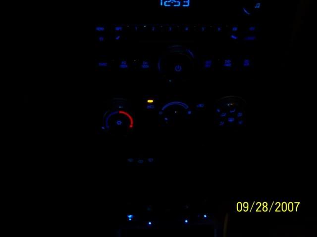

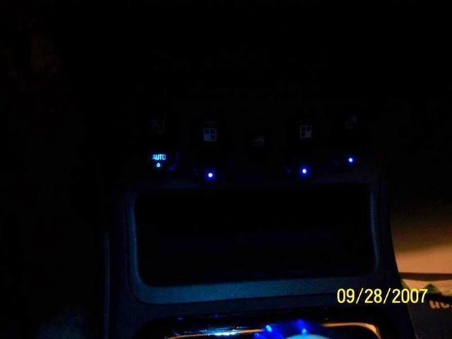

Blue LED's installed in window buttons.....

I sure wish I knew how to take better night photos.....

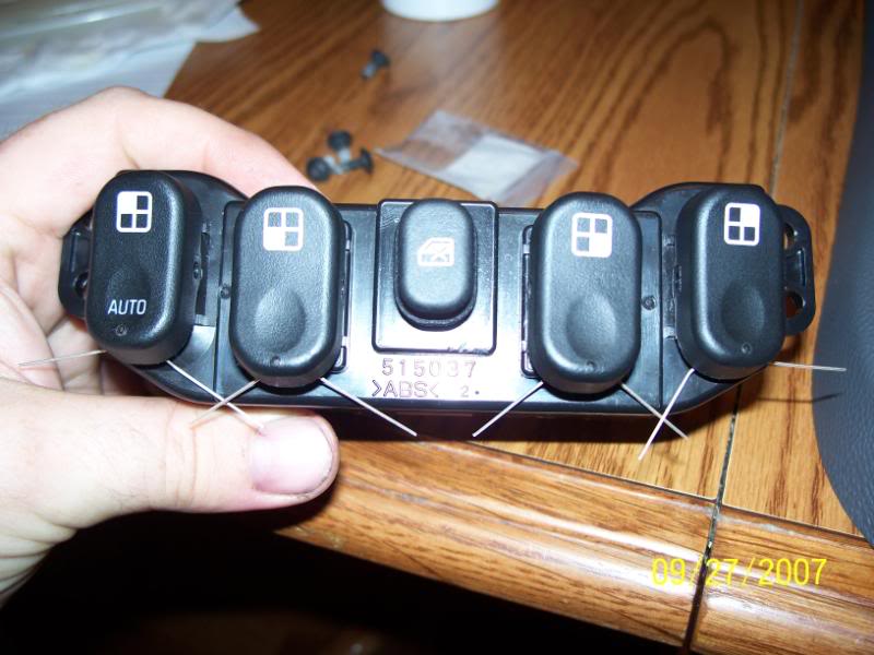

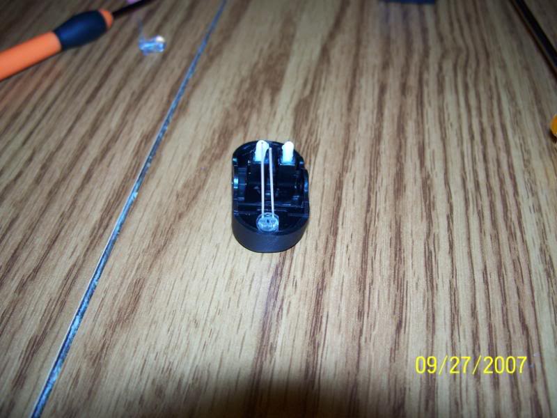

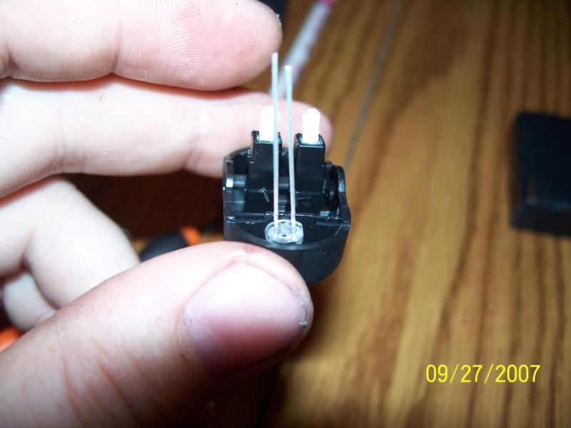

I first drilled 1/16" holes in the bottom of the buttons for the light to come through. I only had 5mm 3 watt LED's left so thats what I used. I sanded the tops flat for clearance and for better light distribution. I would recommend getting the smaller 3mm they would fit better. I then took the buttons off and hot glued them to the underside of the button right behind the drilled hole, put them back on and wired them in series so I didn't have to try and fit resistors in there also. Put everthing back together and wire up ground and 12v source.
