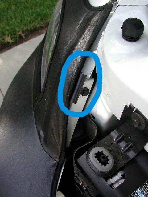

Here's How It's Supposed To Go...
Originally Posted by ANR HHR
Are we talking about this area...
My catches about 1/3 of the way, but is still pretty tight. I plan to just un stich that part and use HD velcro.
Those clips are supposed to fit like this:
To get that fit, you need to detach the bottom bra attachments and slide the clip around the underhood metal, then reattach the lower clips.
(When installing the bra; always do those inner clips before you do the lower clips.)
Piece 'o cake!
