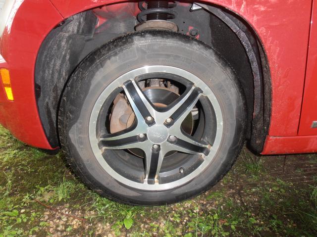

We are going to do a dry run next week to make sure that everything will fit with my aftermarket wheels. If not, I will need get new wheels before I buy the new tires that I need before winter :) I don't want to go the spacer route.

What size are your aftermarket wheels? Some 17's may clear. 18's shouldn't be a problem. 19's or 20's will have plenty of room.
Pretty sure all the folks who have done this swap are using their stock master cylinder. Since it's only a swap to bigger brakes up front and you will still have drums in the rear, the master cylinder should perform the same function.
Now, the SS with it's 4 wheel discs may have a different MC. Not exactly sure. But, the SS does have a different brake modulator valve than the regular HHR's.
uh, i only have 16" wheels, so i guess i am in for new rims..... that is why i wanted to have this done as a dry run first, it gives me time to get the rims before i buy new tires,
i need fat tires because i do alot of camping, with canoes and bikes on the roof and the back filled with gear, also the roads around the swamp are full of pot holes and big rims with skinny tires means lots of damaged rims
so, i'd probaby try to find 17 inchers that can clear the brakes

the 16's didn't stand a chance...... so I ordered a new set of 18's with tires from tire rack....... I spent ALOT of time trying to make sure that what I bought will fit, but I am still nervous.
they should be at the shop tomorrow/Friday and hopefully I'll have the new shoes on for kayaking/camping this weekend....
