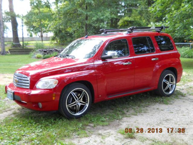

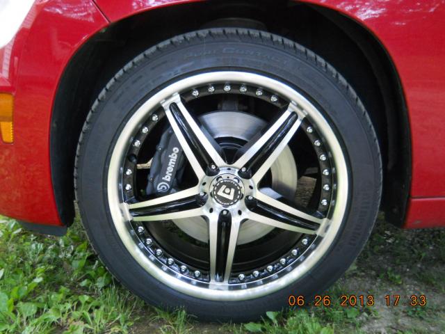

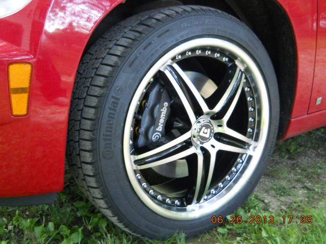

Ta da
Been on the road for a week and loving the Brembos. There is still a small problem with something in the front end, because at certain times I still get a little wheel shake while braking. I haven't been able to reproduce it consistently, but when I can do it for my mechanic, he says that he'll figure it out and eliminate it.
Bought new Wheels with tires mounted from TireRack and had them delivered to the garage where the car was.
Rims: 18" x 6 with 42mm backspacing
Tires: 225/45 R18
I had picked out a set of Michelins, but they were at a different location than the wheels, and the tech from TireRack recommended the Continentals for the same price.
Thanks for everyone's help
