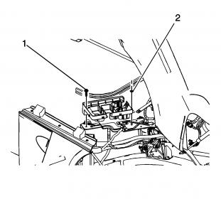

I am getting ready to replace my brake master cylinder. The question is: how do you move the electrical junction/fuse box out of the way, so as to get to the brake tube connections? I can't find any reference to the "under hood fuse/junction box" anywhere in the Service Manual. I can see 2 or 3 nuts, but after I remove them the box seems to still be secured. There are directions for re positioning the A/T & ABS modules, the front part, but nothing on the big box.

ChevyMgr's Avatar
Joined: 11-23-2007
Posts: 8,210
From: Texas
Old Jan 22, 2012 | 05:32 PM
Posts: 26,532
So, there are 2 bolts + the TCM/ECM holding he whole thing in? Disconnect the TCM/ECM then remove the 2 bolts; then the whole thing should just be movable?
