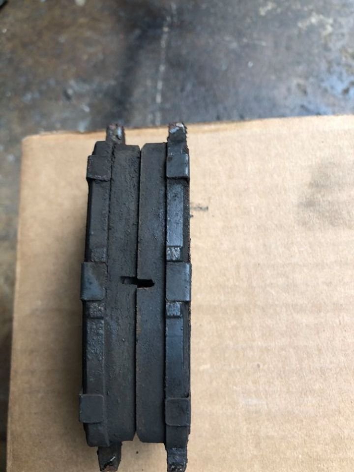

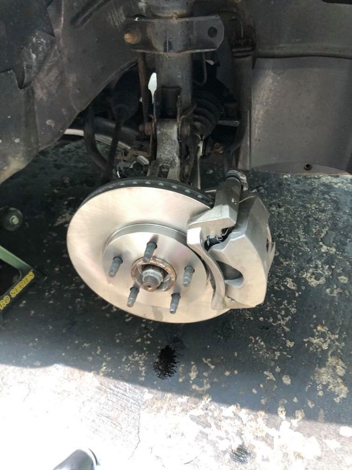

Anyway I got the front done, flushed, installed and bled. Took it for a spin on the highway and went through the procedures to set the pads ( 60mph ride the brakes then hard stops intermittedly ) so she is stoping straight and true, no pulling and that god forbidden shimmy is GONE !!!!!!!!
Going to talk the son in law into flushing and adjusting the rear brake shoes tomorrow at the shop, my wrist is done for... then Ill adjust the e-brake afterwards.

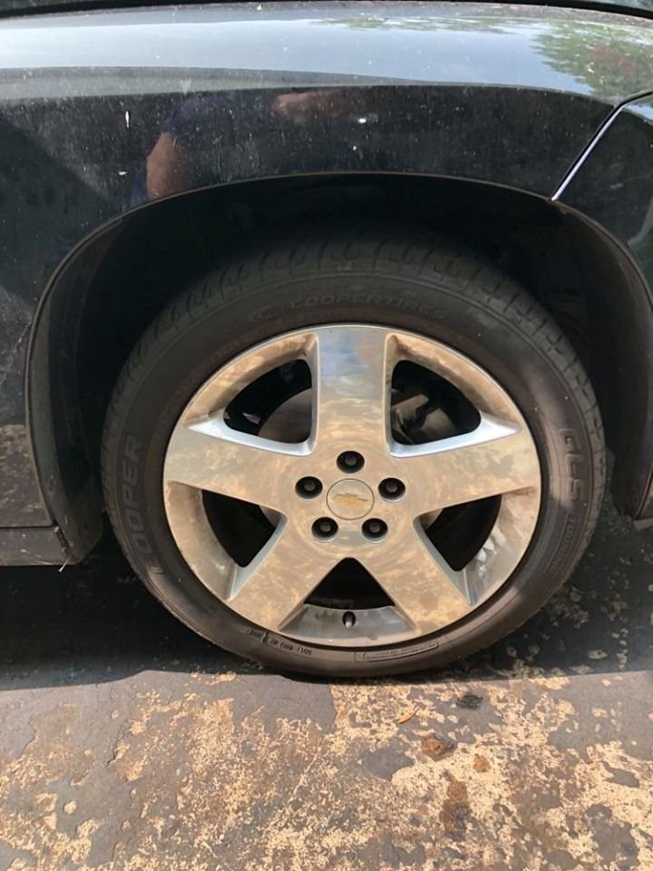

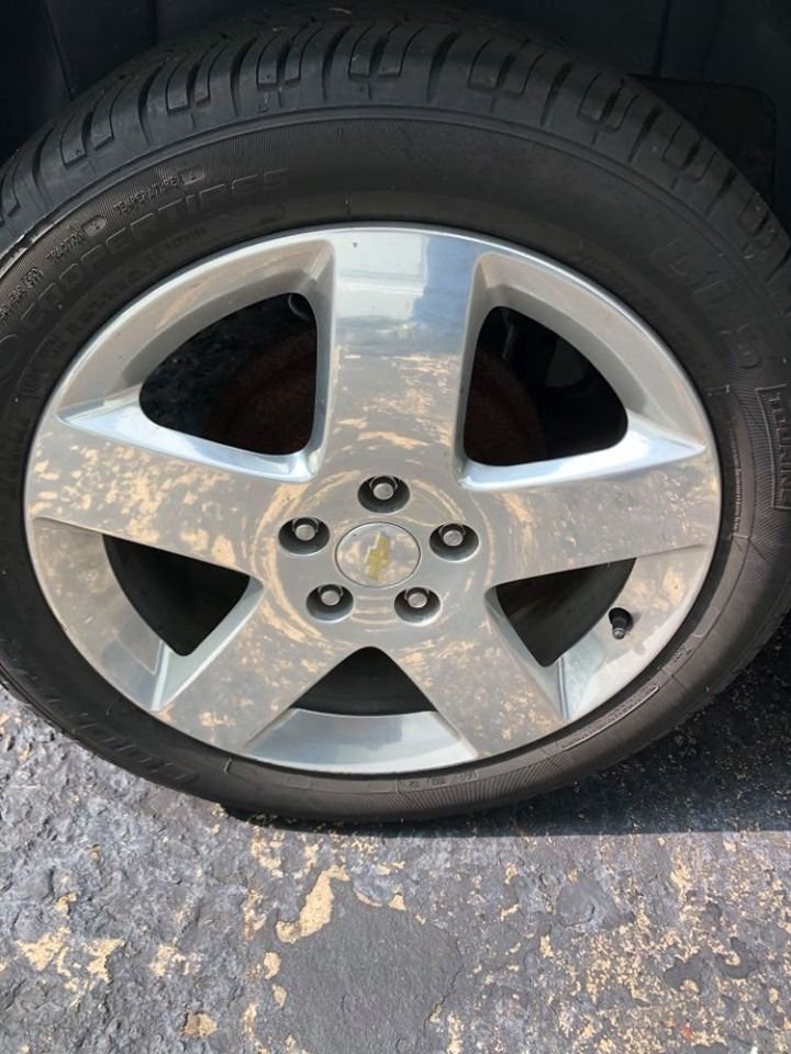

I finally got the rear lugs broke free after driving, guess the heat helped? So I got all my new Black Gorilla Lugs swapped out that I got from Mikey here on ChevyHHR ! Now all it needs is a good wash, not sure if Im going to wax it yet as Im talking to my buddy about paint.

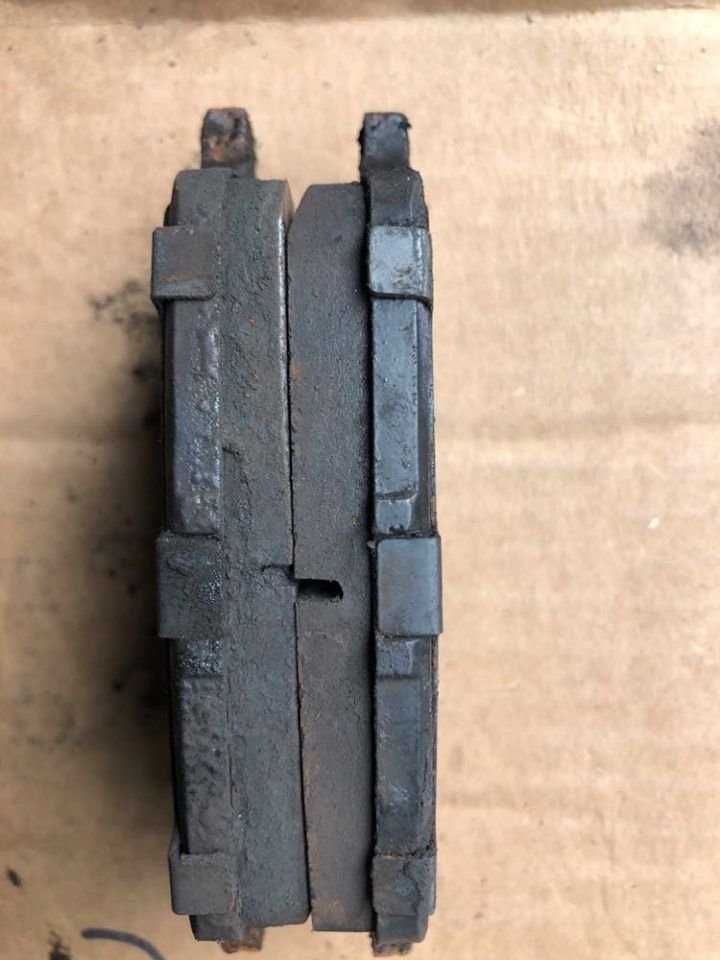

The first set of brake pads are from the drivers side which had the shimmy, Why? I dont know but the pads were wearing diagonally if you look carefully at them and the passengers side was evenly worn in the second picture.
Everything put together and bled, cleaned and washed with brake cleaner to remove all oils and contaminants
Wheels and lugs before and after.
