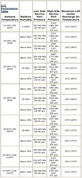

I got the test procedure from ChevyMgr, but most of it involves using something called a "J 43600 ACR 2000 Air Conditioning Service Center" to measure pressure values.
I think what we are looking for is this:

Thank you for your help I will check it today after work it's only 74 and low humdity today so I will refer to the chart. Thanks again

Yeah, by the looks of those numbers in the chart, mine is probably working to GM specs, sad as they are.
I wonder if the stock A/C could be modified for better performance, like changing to a larger evaporator or something?

The weather is just getting nice, 20 deg C or so. The average summer day is in the 25-29 range. The chart says I can count on a difference of 5-6 deg with the A/C, so why even bother switching it on? Its not even enough to keep up with the heat coming up off the dash, Ive tried it.
Hopefully the difference will be more noticable once the real summer weather hits.
