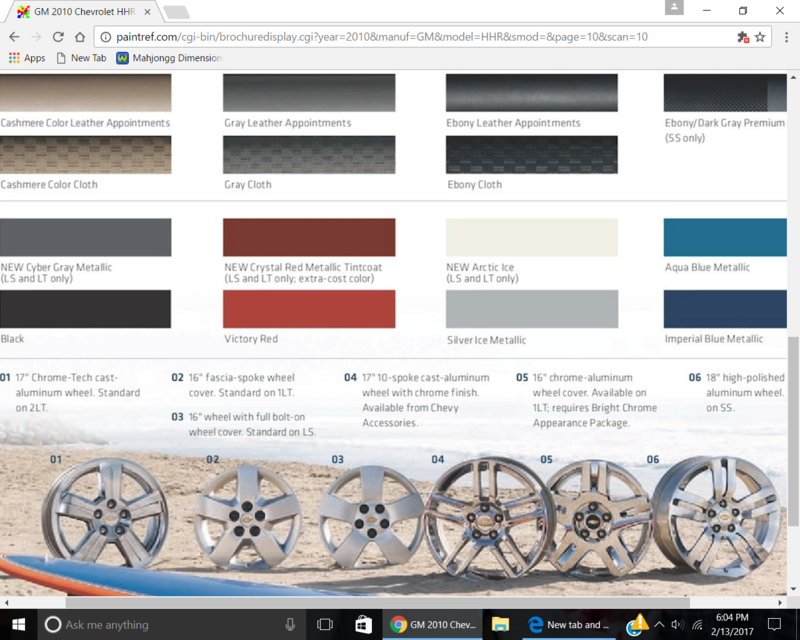

Is it possible to go from a 17 x 6.5 stock Chevy HHR 2LT rim to a Chevy Malibu 17 x 7 rim?
If so will they be an exact fit?

I don't know if Malibu has a 5 X 110 bolt circle and 40-42 offset.

Some earlier Malibu had the same bolt pattern, 2004 or so

Hmm, ok. Well the only reason I ask, is to try to put wider tires on, but thanks to the tire shop yesterday they said the ones I wanted would fit. :)

Unless you know of a rim that looks like the HHR SS 18” rim but is only 17” that would be great. I like the look of them, but also like the cheaper tire size.

The Pontiac G6 GT 18” wheels fit.

Didn't the Cobalt SS have some similar rims but in 17's as you wanted ?

Correct, the SS supercharged had polished 18's, the NA SS had the same in a 17".
There was an optional wheel that was offered for the HHR in a polished split spoke 17", but they are rare.

solman98 must be referring to the rim below. #04 in the picture.
