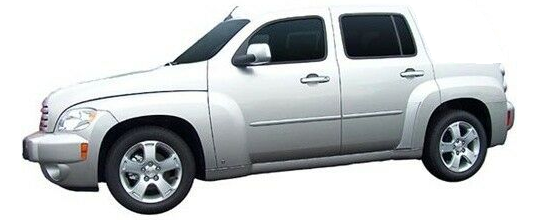

Hi Guys we are in summer!! well close but the weather is perfect for doing maintenance and others change in our cars, so now I would like to convert modify my HHR to a pickup or like that , just cutting the rear part from the roof and bot side, so here in this picture is what I wish, so somebody can give an idea?, tools and if I cut the roof what problem can I face into my car... is just a project!!.

Welcome, it can be done, careful measure measurements, remove the headliner, interior plastic panels, wiring to the third brake light, rear washer hose and wiring to the rear wiper, then measure again, ask yourself, if you are sure you want to do this? Then figure out how to keep water out of the spare tire and battery well.
The tools to cut the body can be a cut off wheel, or a sawzall. You will have to fabricate hinges for the tail gate or just weld it shut.

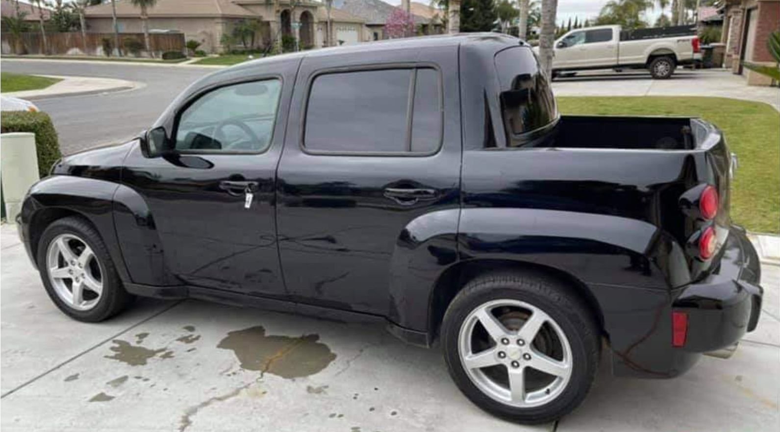

PulpFriction's Avatar
Joined: 12-05-2014
Posts: 3,368
From: Northern Ohio
This one leaves room for the back seat passengers and their heads. Sound concept and nice execution, IMO.
