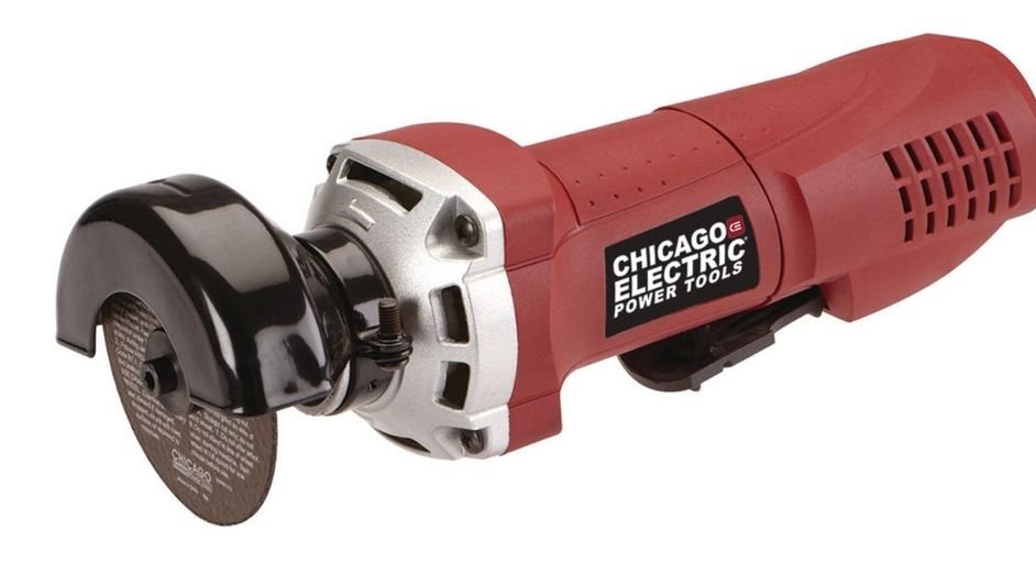

I hardly ever use a sawzall for metal any more.
https://www.harborfreight.com/3-in-H...ool-63023.html
As little as $18. There are better ones.
