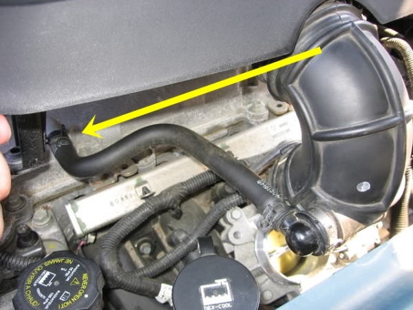

The PCV hose is the hose that goes from the valve cover to the rubber elbow at the throttle body
The MAF sensor is the device in the tube going from the air filter box to the elbow at the throttle body

Originally Posted by donbrew
Did you hook the MAF up, did you address the PCV hose?
Just wasting my time?
Ok thanks. I'll check out the pcv hose. As far as the sensor goes I'm pretty sure its fine I just unhooked it to take the engine cover off.

quote: "As far as the sensor goes I'm pretty sure its fine I just unhooked it to take the engine cover off."
That's what they were trying to tell you earlier. Your video shows the engine running without the air filter housing attached. Which means the MAF sensor was unplugged. Which means the engine won't run correctly because the MAF can't communicate with the engines computer.
In other words, the MAF is probably fine. Just needs to be plugged up for the engine to run good.

Just a piece of fuel line will suffice, I believe 3/8 ID

I checked pcv hose. It has a few scrapes but no holes or leaks. I think the crappy phone camera was playing tricks.
On my way to oreilly to have the codes checked, the check engine light went off. Drove around for 45 minutes and it never came back on. *shrug*

Because you plugged the MAF back in!
