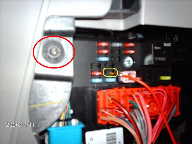

You can use this slot from the inside fuse panel. It's swithed with the ignition so they will turn off when you turn off the ignition. The bolt is also a good ground.
